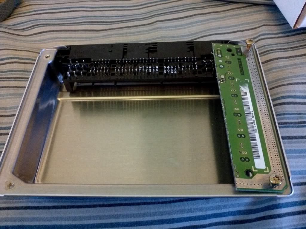

          • hoveringuy
            • Dec 2005
            • 2753
            #110
            You could leave them on the board and cut the board out around them. That way they're mounted and have some heat sinkage.
            You could then scrape off some of the protective screen and solder output directly to the pad.
            • Elysian
              • 674
              #111
              Oh good call, that'd make things a lot easier.
              Would a heat gun be the best way to get the main connector off of the board?
              • hoveringuy
                • Dec 2005
                • 2753
                #112
                Yes, heat gun. hold the board in a vice. Make sure the connector isn't mechanically attached to the board in any way (screws, snaps, etc.). Practice on some of the chips to get a feel for the solder. Start on the end of the plug away from the coil drivers and work your way down. As you heat from the back gently pry and it will slide out like buttah.
                • Elysian
                  • 674
                  #113
                  Excellent, just picked up a Hakko 1300w heat gun.
                  • Elysian
                    • 674
                    #114
                    There we go. Now to cut a pair of holes for the MS3X and main harness.

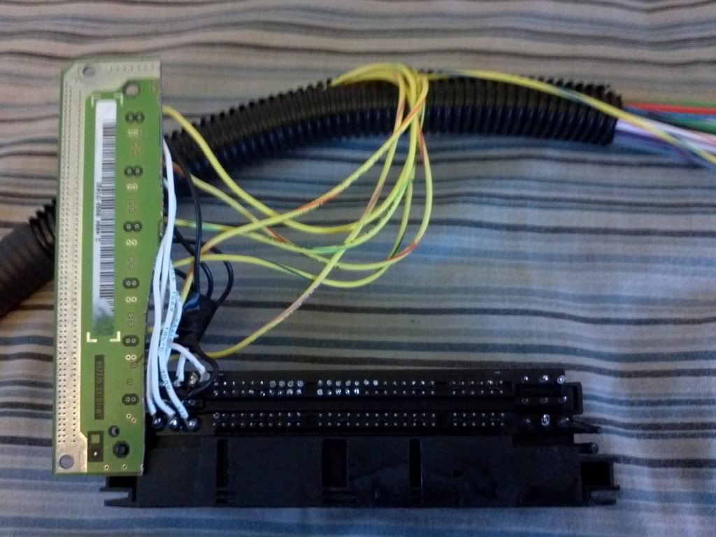

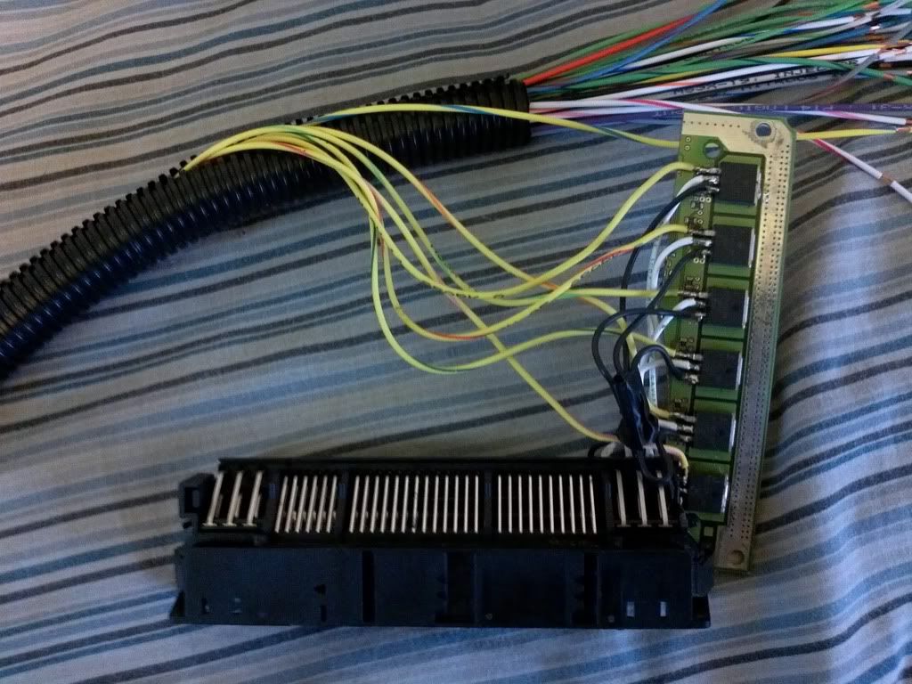

                    • Elysian
                      • 674
                      #115
                      Here we go. I decided to have the drivers just go in order, 1-6. I sorted out the firing order in the MS3X harness. I've checked continuity and made sure there are no unintentional connections anywhere. I used the middle connector instead of the back connector for ease of soldering.
