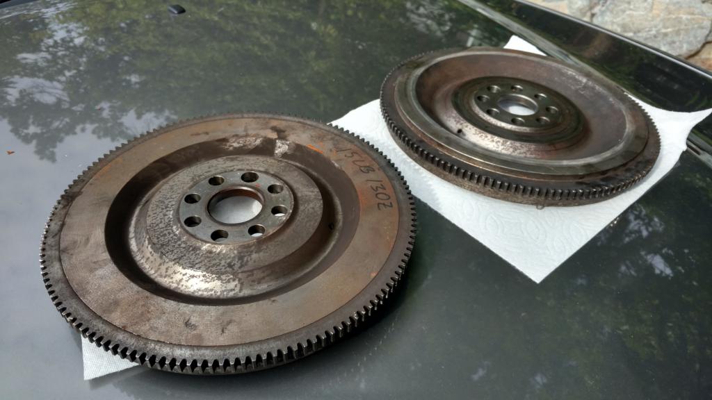

    Clutch/flywheel:
    So when I first converted to the M54 I noticed soon after that the stock clutch was slipping. I installed a Clutchmaster FX-100 PP/disc and at the same time lightened the flywheel by removing the material on the rear of the flywheel down to the ring. The resulting flywheel weighted 15lbs, 6Oz, down around 3lbs from stock.
    The engine was definitely a little revier and after a few hundred miles the clutch held just fine, but it was also "grabbier" and the lighter flywheel made it more difficult to drive smoothly without stalling.
    Now that my son is starting to drive, I'll be using the same PP/disc, but I wanted to revert back to the original flywheel mass. Unfortunately I forgot about the clearance issue so I'm having .1" taken off the back.
    Back of the lightened flywheel and OEM.
    I'm curious to see what the additional flywheel inertia does for drivability...

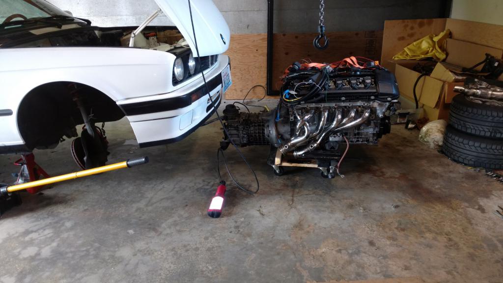

    Originally posted by butters View Post
    Good work. I'm wondering about your removal process - was the rear of the car resting on the ground (on the tires) or did you have it supported as well? I was thinking of using ramps to get additional height.
    What kind of height do you think you needed at the frame rails below the doors in order to get the power unit out on the dolly?
    Rear was on the ground. I think it was actually beneficial that way because the increased angle raised the front more, where the clearance was required.
    I had two medium-sized jacks and they were at about 18" extension. The clearance under the front lip was maybe 26" at that point.
    I liked that everything was smooth and controlled. What I didn't like about the engine lift from-the-top method is how the oil pan hangs up on the subframe and there's more "persuasion".
    What I really like about this method is that I can do it with what I have on hand. No arranging to borrow a cherry picker. I did order a chainfall for $40 from Amazon, it's been working great for lifting the engine off the stand and such.
