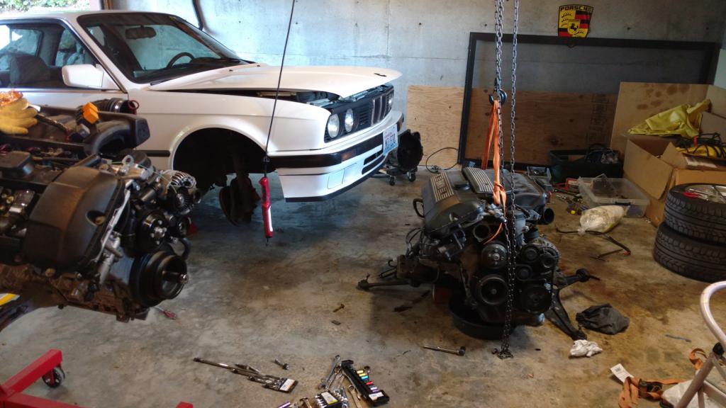

    Removal was quick and painless.
    My only mistake was that I overlooked the throttle cable and clutch slave line. No big deal...
    I found that the dolly height of around 4" left plenty of clearance to access all bolts once the engine was lowered to rest on it. I raised the body by placing one jack on each side of the body, under the rail beneath each door. It was necessary to tap and pry the subframe after the body was raised the first several inches because the alignment pins were causing it to hang-up.
    The engine was also not perfectly balanced on the dolly so it tipped a little.

    Begin swap!
    So I have everything unbolted/removed. driveshaft, exhaust, radiator, A-arms, sway bar and steering shaft. Fuel lines, grounds, etc, etc.
    So my plan is to lower the the car back onto the furniture dolly, unbolt the remaining two bolts in the subframe and the two 13mm for tranny mount.
    It all seems pretty straightforward. I assume I'll have clearance to reach the subframe bolts with the body lowered? The furniture dollies are only about 4" tall so I'm guessing I may need some wood spacers.
    I'll have it out this weekend, fer sure.

    Couple friends to get the motor on the dolly.

    That's kinda how I imagined it. Jordan's post is good and to his point, I've always removed the hood and wouldn't need to like this. He said "no hoist required..." and if I can avoid that it resolves a lot of logistics, except how to move motor from engine stand to furniture dolly and vice-versa?
    Would I be able to raise car body with a jack and progressively get it higher with wood blocks until I can pull the motor clear?
    Would I lower the motor onto the furniture dolly after disconnecting drive line, exhaust, etc by just lowering the body off the jackstands with the dolly under the motor?

    Originally posted by 2mAn
    I would assemble the motor, trans, subframe and everything all together and install it all from the bottom if you have the means to do it this way. Im quoting the post that Jordan did showing how his all went it in
    Furniture dollies are awesome. I have about 10 or 15 of them around the shop. Even made a giant one that a suspension-less car can go on, and one that's 3'x6' that works great for sliding drive trains in.
    Leave a comment:
  • 2mAn
    replied
    Originally posted by Jordan
    My neighbor wandered on over this evening to help me lower the engine off the stand onto the furniture dolly. Between the two of use we just managed.
    With some scrap seat belt between the lifting loops, and a 6ft 2x4 through the center we easily shouldered the load and lowered it to the dolly. Easy peasy.
    6spd specific flywheel and new clutch kit installed.
    Transmission and starter installed, so much easier to slide together here than try to bench press under the car.
    Rolled under the vehicle.
    Then it was as easy as lowering the car slowly and controlled with my jack down over the powertrain package. No removing the hood, no paint damage, and no hoist required!
    Engine installed with subframe bolted up to the body.
    Some might chuckle at the furniture dolly method, but I'll be damned if it didn't work slick as hell.

  • ForcedFirebird
    replied
    I prefer to pull them out the bottom. Get everything disconnected except the sub frame bolts. Support from the bottom and remove the last 4. Then you can use an engine hoist with a strap on the bumper to lift the car off the drive train. Usually I do it on a floor lift, but have used an engine hoist many times at home, and once at the shop when the lifts were full.

    Ok, question:
    I've always pulled my motors with a crane and lifted forward and up. In this case, I'll also need to change my subframe for the ArcAsylum rear oil pan modification.
    Is it still better to lift the motor or should I think about removing with the subframe? I've just never done it that way.
