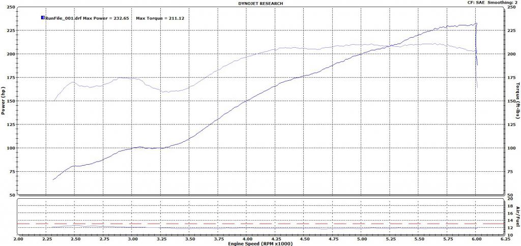

    Giving up DISA and /or the new exhaust seems to have cost a lot of torque below 4000rpm?
    Looking back at your earlier dynos this change definitely takes you over to the Dark Side! - Top end high revving power gained at the expense of torque below 4k rpm.
    It would be interesting to see this dyno compared to a stock M50B25, not for absolute figures, but for how the power is delivered. I suspect you've gone a long way to achieving your objective of performance like the M50B25 with a rising crescendo as it comes on song over 4000rpm?

    if anything, a bit of mechanical retard is helping your top end power - assuming it's the intake cam.

    Here's the plot. I'll let everyone digest this and then post the old motor superimposed with this plot.
    Keep in mind, intake cam static timing is off by 6 degrees (more retarded), VANOS seals are weak so the cams aren't tracking that great, ignition timing is probably Ok but not optimized. Fuel seems fine.
    Of course, the 6000 rpm rev limit ghost in the software.
    Still 232 at 6000 isn't a bad start...
