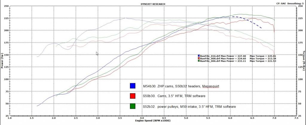

          More dyno data... the S50-S52-M54 comparo!
          These are two other cars that ran during the dyno day. I've included the known mods.

            Wow, the torque difference is huge! Nicely done :up:
            edit: I'd be curious to see the dyno overlaps on 100% stock motors too. Not that you can provide it, but it would be fun to see.

              Yea that torque is sexy, + aluminum block = perfect swap.
