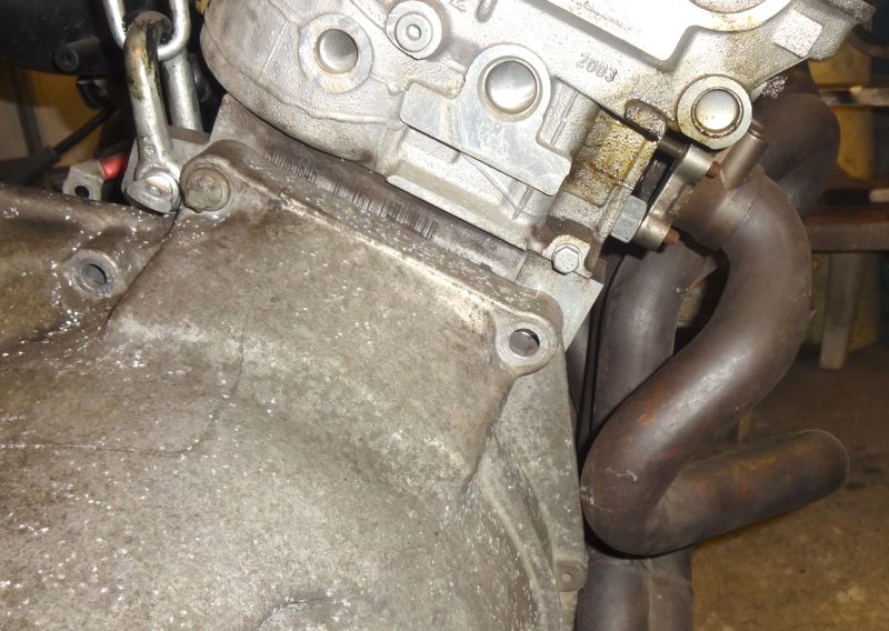

                            Originally posted by hoveringuy
                            This will be step one. #6 pokes the firewall and either the firewall needs to be "adjusted" or the runner re-routed.
                            I will re-route (maybe a little firewall massaging).

                              Originally posted by Doni
                              Nice project. I really like when people put some effort on details!
                              Would you like to share some more details about the S50 header fitment. I'm working on a E36 M54 track car and planning to use S50 headers. The problem is that cylinder #1 pipe hits the engine block even though I tried a 0.4" spacer between header flange and cylinder head. Did you bend the pipes or how did you solve the problem?
                              Yeah... S50b32 headers are a really S.O.B. on the the M54 because the aluminum block is slightly thicker in a few places than the iron block which interferes with some of the runners.
                              To compound the issue, the s50b32 headers have individual flanges for each cylinder instead of having 3 or 6 cylinders share a flange like some other headers. So... if you heat or massage one pipe it can easily get get mis-aligned and be a b!tch to install.
                              I finally did a combination of grinding off some block material (not much!) and slightly crushing the pipe.
                              Double gaskets can help, too.

                                #435
                                I think the sealing surface is "deeper" in the M54 head than on S50 engine. That is one reason why they hit the block. The headers hits also the 5-speed ZF transmission which is used with the same headers in S50B30.
                                You can see from the attached picture how it goes with the transmission even though I have a 10mm thick nut under the flange.
                                I'll get a 12mm thick spacer between cylinder head and headers. If it works out then the bolts has to be replaced with longer ones.
