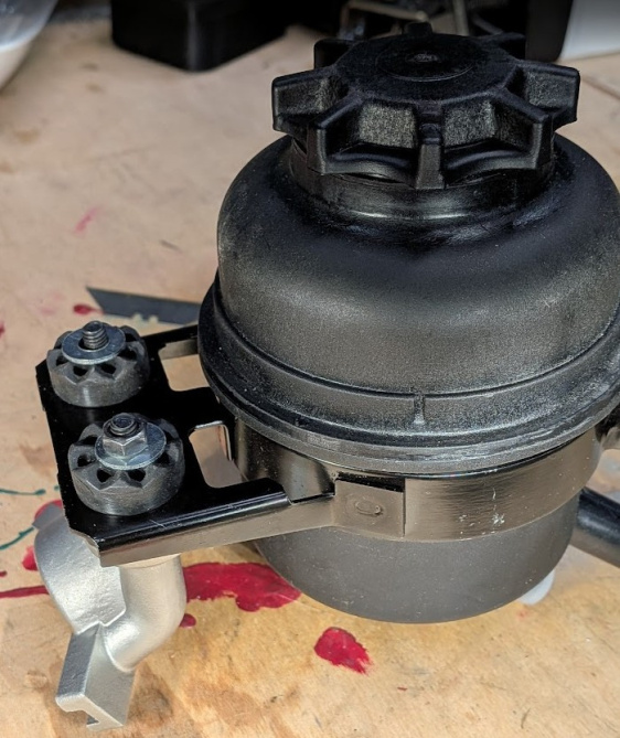

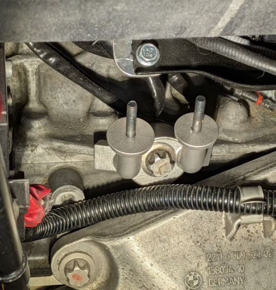

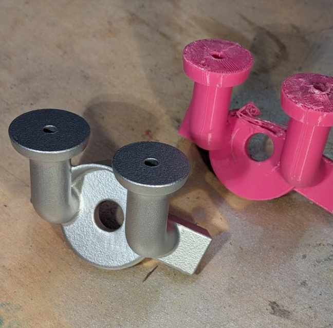

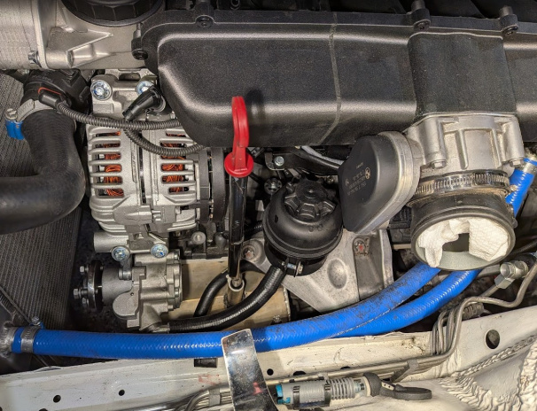

      I'm pleased with this!
      Nice thing about the "Euro" intake is that it opens up a lot of room where the DISA stuff used to be. I designed and printed in aluminum a little holding fixture that uses the stock E90 PS reservoir and positions it down and out of sight.
      Not up on the fender strut mount anymore, no more lines running down from there, but still accessible and functional. (still waiting on the correct washers...)
