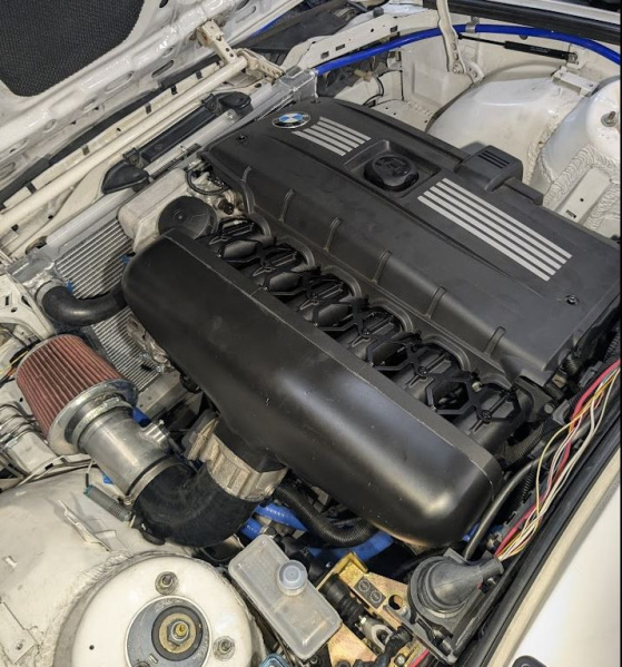

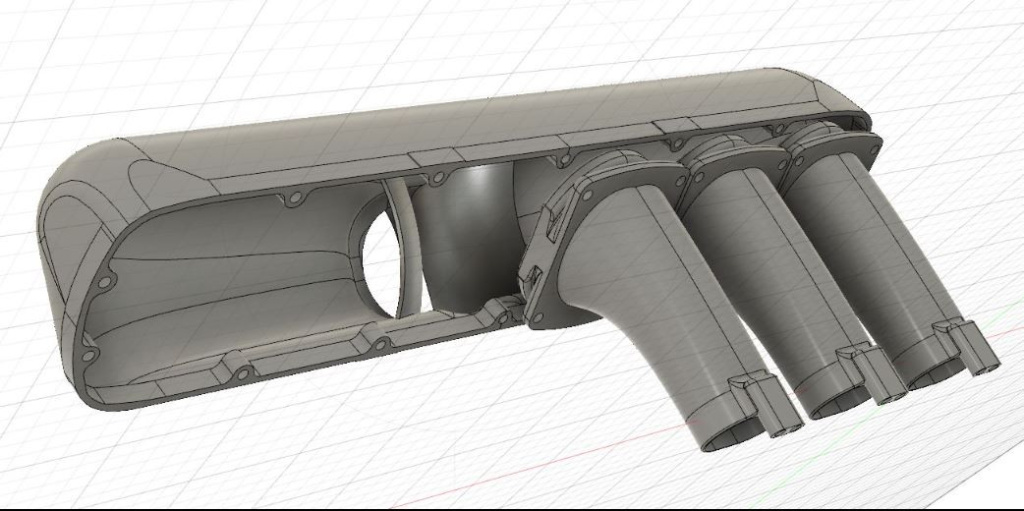

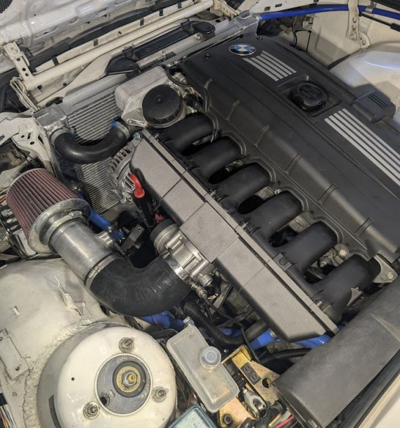

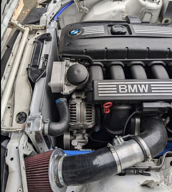

                        Time for an update. As background, I originally installed the N54 intake because it fit easily and drove that for a year. It screamed on the top end but was a little stumbly for highway cruising or around town, so I fit the DISA intake which is dreamy as a daily but runs out of breath after 6000.
                        adam.nonis has been busy with a lot of stuff but still managed to design and fit three completely new intakes.
                        The first two are variations of using the stock N52 runners, chopping-off all of the curvy tubes and fabricating a plenum that mimics the M50. One has some extra taper to clear a booster. These weigh a svelte 4lbs 5Oz compared to the DISA manifold at over 10lbs. I've already driven this one and it rips! I Test-O logged it and found that my tune is already spot-on and won't require changes to the fuel map (but will need DISA turned off...). It's also perfectly tractable at lower rpms, responds well without chugging but still builds power past 7000rpm. It's a winner!
                        The second manifold was built from scratch with printed trumpets. It has bigger plenum and experimental vanes that were tuned through CFD to help distribute flow evenly to all 6 runners.
                        So, the next step is I need to get the car to the dyno. I'll baseline the DISA intake and then run the others and maybe an N54 one as well.
                        DISA, stock runners and 100% fab intakes.

                        DISA intake is made for soccer moms. Lots of curvy pipes and circuitous routing kill top-end flow.

                        Many bothans died to bring you this design. The gaping runner mouths necessitate a corresponding large plenum.

                        It fits, but only good enough for the dyno. Intake elbow rides on the fender liner and I had to remove the wiring trim cover. If it performs the design can be revised to fit better.

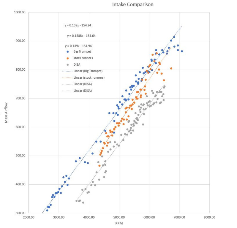

                            I drove each intake and logged on TestO. I grabbed some data from each intake where I was at 100% throttle and combined it all into one graph that compares the mass flow rates vs rpm. How will this translate to power? We'll see...

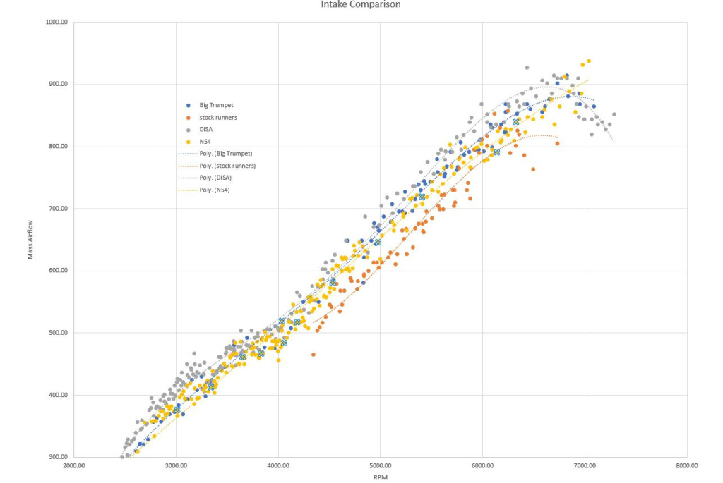

                            *updated* installed and logged the N54 intake (yellow). It's "chuggy" at part throttle and lower rpms and doesn't offer any advantages over the trumpet intake.
                            So far,
                            -DISA seems to outperform below 4000 and it falls-off at 6500.
                            -N54 doesn't flow much better until the very top.
                            I need to re-log the other two intakes with more focus on WOT. I don't think the intake with stock runners is representing right.

                              I know that the 3-stage manifold falls flat above 6,600-ish RPM, but it still pays to rev it out pretty high unless you have a very short final drive, since it will keep you in the meat of the powerband better after shifting. If you take the CSV export of your dyno plot and map it in a gear shift calculator, you can know for sure.
                              There seemed to be some debate earlier about the accuracy of the dyno RPM calibration. It should be noted that with Dynojet (or inertial dynos), it does not matter at all if the RPM is calibrated accurately. It will not affect the torque number, and it might, at most, affect the HP number very slightly. However, on Mustang and other load-cell dynos, it is critical that the RPM be calibrated properly, or it will greatly skew the numbers.
                              What flywheel/clutch/crank damper are you running? How are the harmonics at 7,500+? I'm on a Valeo single mass with the stock manual crank damper, at the motor is pretty buzzy over 7,200 RPM. I have my redline at 7,400, but I really only go there if I have to, like saving a momentary shift at the end of a straight.
                              RISING EDGE
                              • hoveringuy
                                • Dec 2005
                                • 2747
                                #60
                                It seems like power stops building by around 6200 and after that it's just going through the motions, but yeah, it may pay to stay on it for the next gear, but overall it just feels like so much is missing....
                                The eddie current dyno isn't the greatest for "true" power, that's why I put it on the inertia for accurate accounting. The eddie current is fine for comparison, such as running all the intakes on the same day.
                                I've never even split the transmission, I still have the OEM dual-mass and it's pretty smooth.
