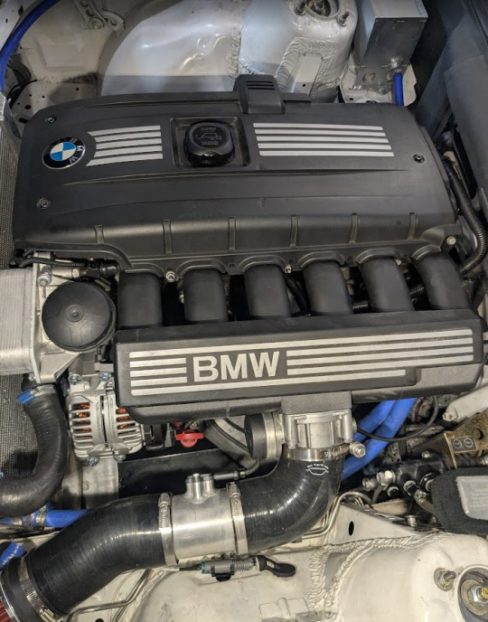

                    I have an e91. I’d like to put it in both the e30 I’ll be swapping and the wagon. I’ll take pics of the stock intake in the e90 and post them.
                    • JRowe
                      • 352
                      #85
                      Here’s the wagon and some underhood pics. Looks like there’s room but would need to move the ps reservoir and perhaps get rid of the stock airbox.

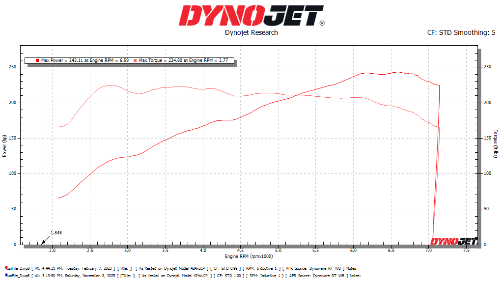

                          I dropped the car at 22RPD these last 2 weeks for a "real" tune on the hybrid intake. They basically used their off-the shelf tune for their version of the trumpet intake and tweaked a few things.
                          Picked it up and the car drives great, definitely filled the mid-range in where it was a little weak and it's much punchier now.
                          So took it to a Dynojet for some "real" numbers.
Name:	Screenshot 2025-11-08 150436.jpg
                          Engine as it sits. 100% stock N52 aside from S54 headers and a hybrid "euro" intake. Still has MAF and a cone filter.
                          This is what it did with the DISA, which wasn't bad. 243 is pretty decent.

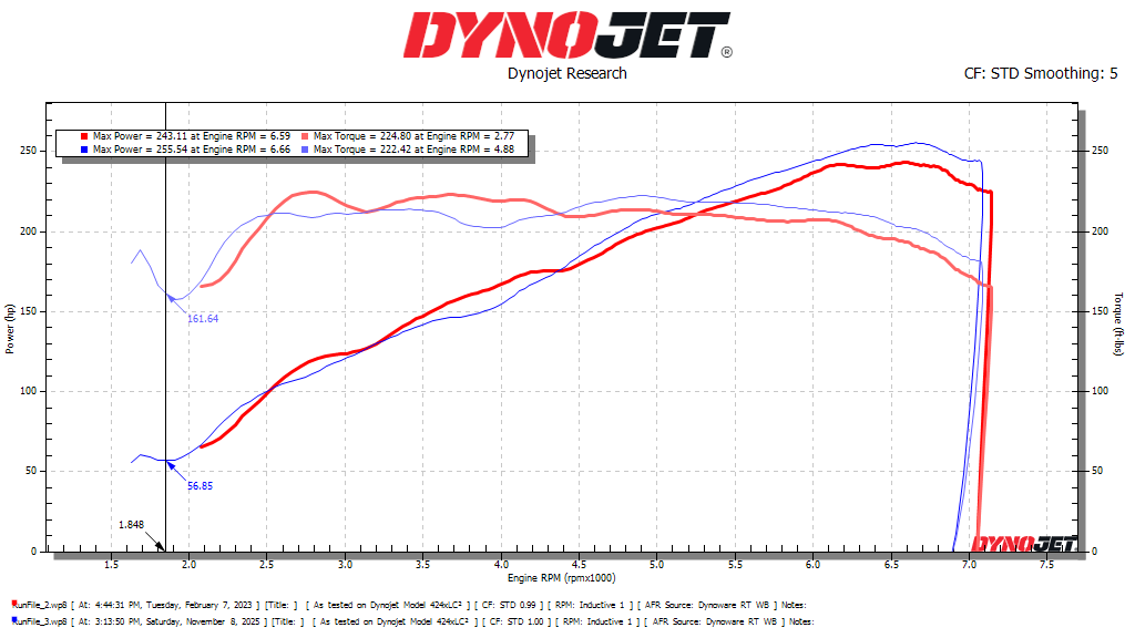

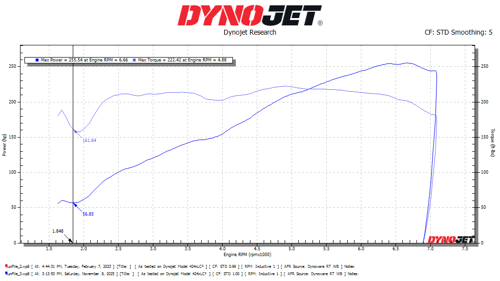

Name:	Euro intake.png
                          Here's with the new intake. Torque is obviously slightly weaker down low,
                          Both combined. My data from the N54 intake shows that it's pretty weak until 6000 and then it peaks a few hundred rpms past the blue line and carries a little less power higher up.

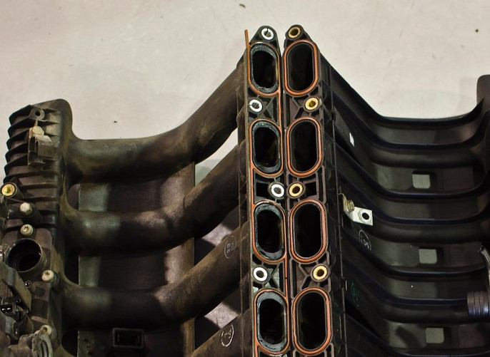

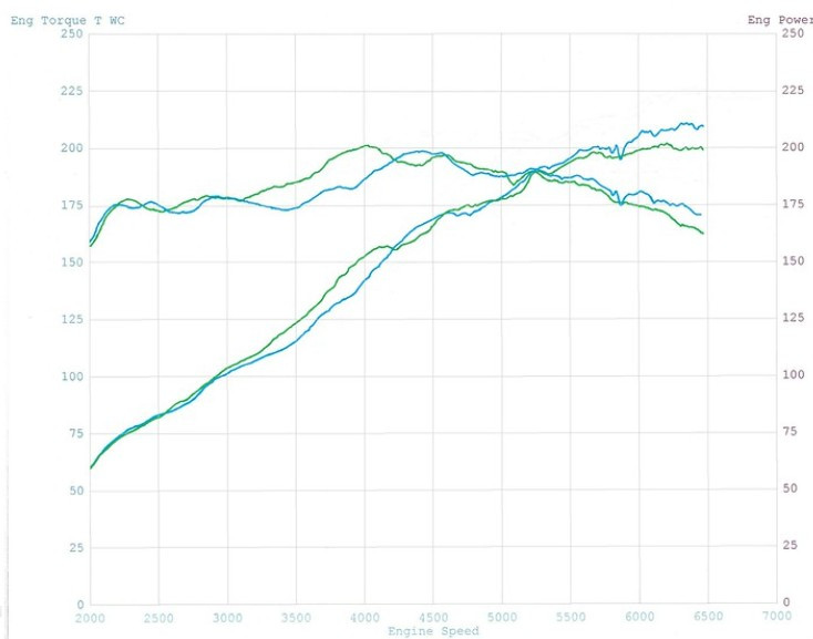

                              I think we all remember the M50 vs M52 intake comparisons, the M50 did better up top but gave up some torque, but even being 30% larger the gains were limited to a relatively narrow range. This N52 comparison has the exact same runners but removes the curvy stuff before it so probably why it's higher, has the same shape and only slightly shifted right. Kind of like with and without a restrictive filter.
                              I'd love to see a comparison of the M50 runner area compared to N52, but I suspect it's smaller than M50.
                              M50 also had 10.3mm of lift where the N52 is 9.7mm.
                              I'm highly skeptical of MILVs adding 1mm of lift, but I think a Schrick intake cam would uncork another 10-15hps.
Name:	Screenshot 2025-11-14 170235.jpg
                              M52 and M50 intakes
