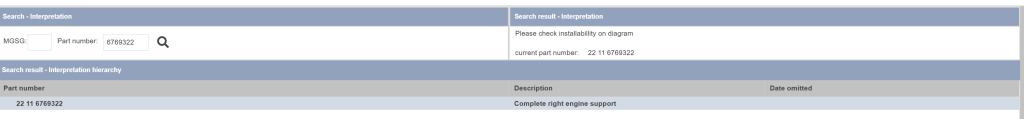

            Does anyone know if the 22116769324 is a sub or succession for the 22116769322 support? Real OEM doesn’t recognize the 24. Seller says its from and E85.
              the 322 mount has never been superseded before. 324 might be a pre-production/production line part number but it isn't a valid part number.
