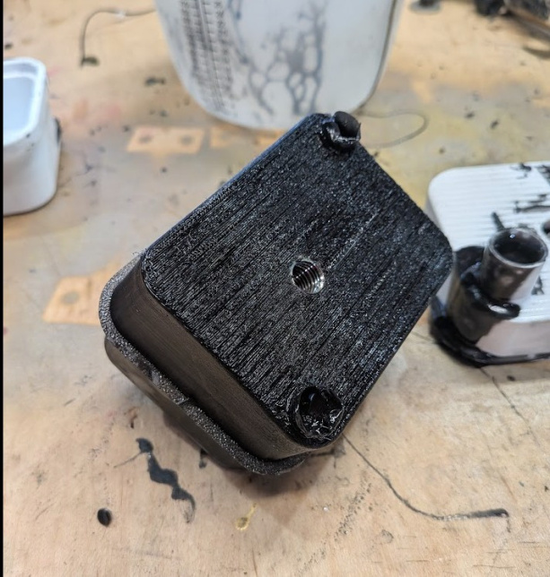

              It is a lot easier to make custom mounts than to modify the mount arms. I have not switched to N52 yet (hopefully start swapping this fall) but have been running these DIY motor mounts with an M52.
              These mounts were designed with flexibility, adjustability, and prototyping in mind. Using a combination of 3D printing and cast urethane, I 3d print them first to allow for precise fitment and testing before final casting.
              Key Features:
              • Shared Plate Design – Top and bottom plates are interchangeable from left to right, simplifying production and reducing cost, all metal plates can be ordered from Send Cut Send.
              • Interlocking Internals - Internal structure fully interlocks with each-other, catastrophic failure / separation should be none to very low.
              • 3D Printed Test Fittings – Initial prototypes are printed with a threaded M10 insert hole, allowing a stud to be screwed in for test fitment.
              • Precise Positioning – Mounts can be fine-tuned during the test-fit stage, ensuring the engine sits exactly where desired.
              • Urethane Casting – Final mounts made from polyurethane, I used SRC Flex-It 70 (70A hardness), cured in a pressure pot to eliminate bubbles.
              • Controlled NVH Tuning – The 70A mounts are actually pretty stiff, voids can be intentionally designed into the mold to soften the mounts and reduce noise, vibration, and harshness.
              • Engine Position Adjustability – Mounts allow slight (about 15mm) forward/aft engine movement to suit different setups.
              • Future Material Options – Other casting compounds may offer longer working time or better vibration control compared to SRC Flex-It 70 (note CAD below is wrong saying 80A).
              • I have been running a set of these on my M52 for about 2 years with no problems although I do not get to drive my E30 as much these days, they are on the stiffer side.

                  I have never seen the inside of the AKG mounts but it would probably be something similar. It would be easy to move the top plate hole forward or back & tack a nut to the inside to run studs. I have the file that can be modified or ready to be sent to Send Cut Send, do we have a place we are uploading CAD files. I also have an extra set of plates and hardware you can have if you want them.
                  Cost to make a set of these is under $85 (gets much cheaper if you make more than one set)
                  Cost breakdown:
                  Send cut sed metal parts $33 (this is the price when I ordered enough to make two sets $66/2)
                  Bolts & Hardwar $9
                  Polyurethane resin $28 (this would be enough to make at least two sets)
                  3D print PLA $2
                  Mold release $9 (might not be needed, I have not tested without it, or another filament might work better)

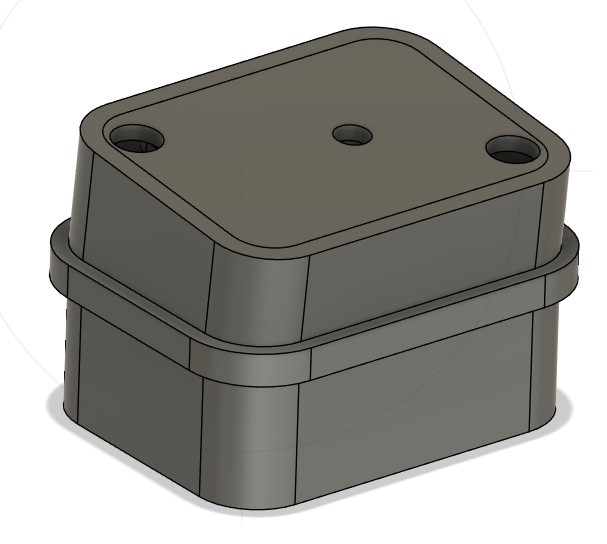

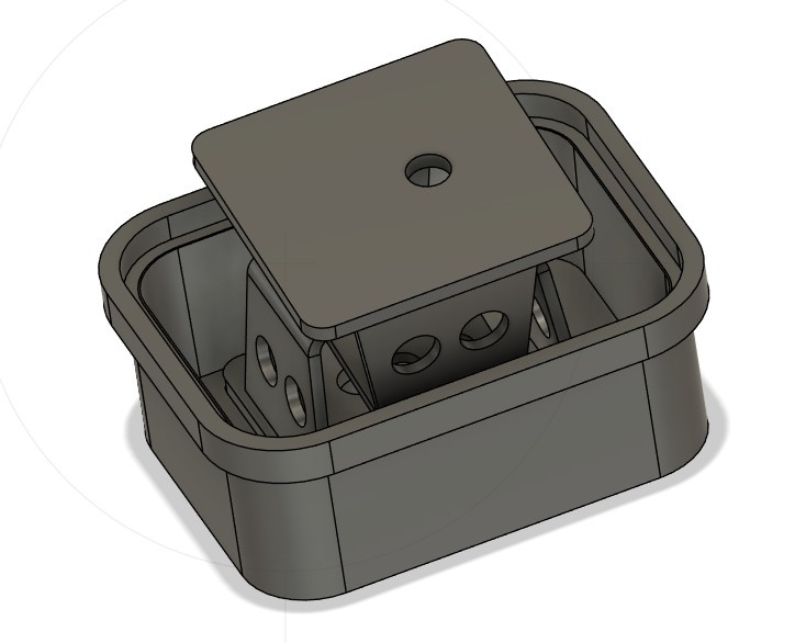

                        Here's what I did today because I actually have time!...

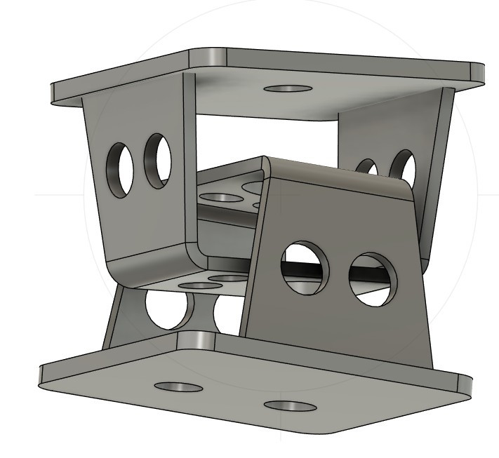

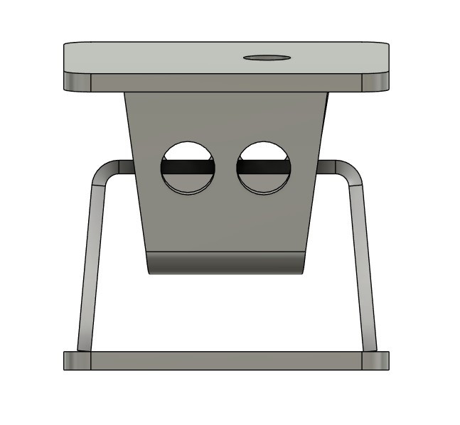

                        This is the internals to the mounts.
                        Click image for larger version  Name:	Screenshot 2025-11-28 084826.jpg Views:	0 Size:	32.1 KB ID:	10151821 Click image for larger version  Name:	Screenshot 2025-11-28 084902.jpg Views:	0 Size:	62.2 KB ID:	10151825
                        The top side gets a nut welded on the bottom of the plate, the bottom gets a locator pin and a stud. The respective sides get bolted to the halves. Each half has 3 degrees of taper for de-molding. I don't expect them to just pop out, but I just printed a set in PLA so I'm fine if I need to destroy the mold.

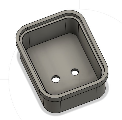

                        Click image for larger version  Name:	Screenshot 2025-11-28 121000.jpg Views:	0 Size:	37.6 KB ID:	10151824 Click image for larger version  Name:	Screenshot 2025-11-28 121038.jpg Views:	0 Size:	53.0 KB ID:	10151822
                        ... and then polyurethane gets mixed and poured through the sprue (I need to give them chimneys...).
                        AKG uses Shore 70A but I've ordered 60A for my first attempt. Need to get a vacuum pot and also a pressure pot, according to AI.
                        Click image for larger version  Name:	Screenshot 2025-11-28 121140.jpg Views:	0 Size:	40.7 KB ID:	10151823

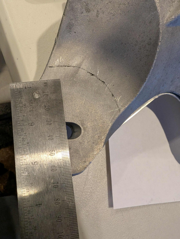

                          Nice, look similar to what I have been slowly working on for N52 E30. If the polyurethane that you are getting has a short working window (under 15 min) I would skip degassing under vacuum and just pour and let it cure in the pressure pot.
                          Some data I collected so far (let me know if what you measure is different):
                          -Z4 arms are tilted about 15 degrees
                          -E30 subframe mounting point is tilted about 20 degrees
                          -The passenger side mounting surface of the Z4 arm is not flat as it goes towards the front of the engine (as you slide the engine towards the rear). I looks to have about a 40mm radius from the bolt hole of flat area. It is hard to compare yours based on the pictures but it looks like they may extend out of the flat area.
                          -I still need to get the mounting hole spacing of N52 arms and the E30 subframe.
                          Attached are pictures of the Passenger side arm with the approximate flat area marked and a test mount with threads modeled and printed with stud threaded in. This mount was only made for test fitting but I drove on it and it held up good but deformed from heat of the engine arm.

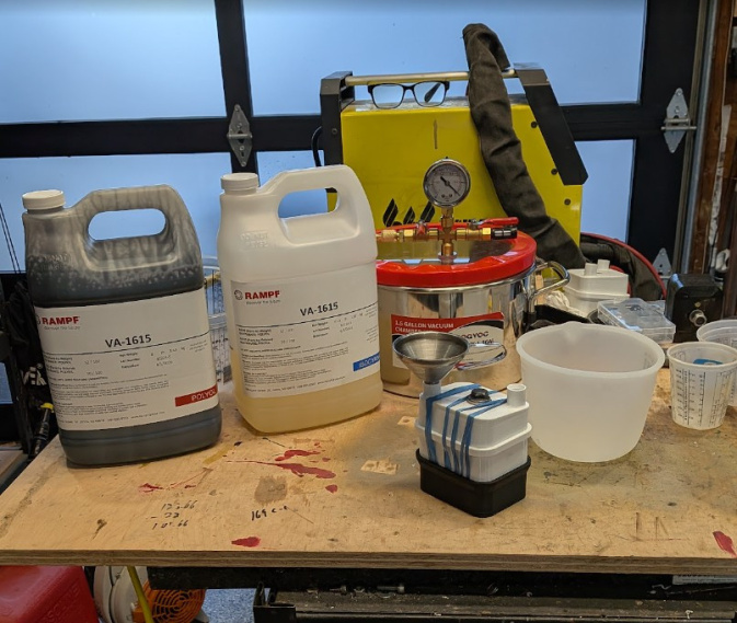

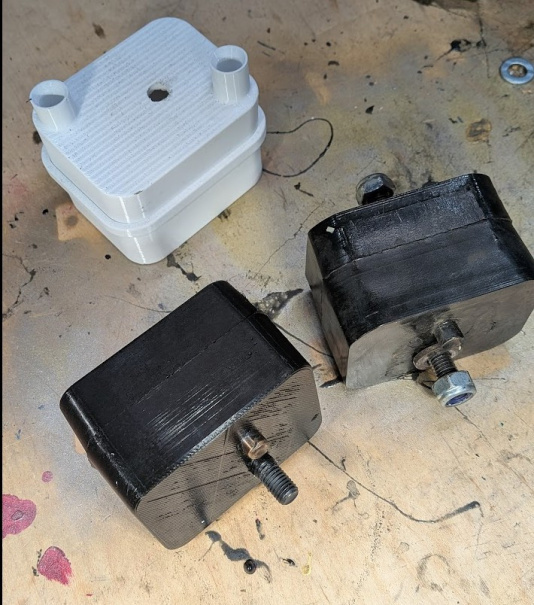

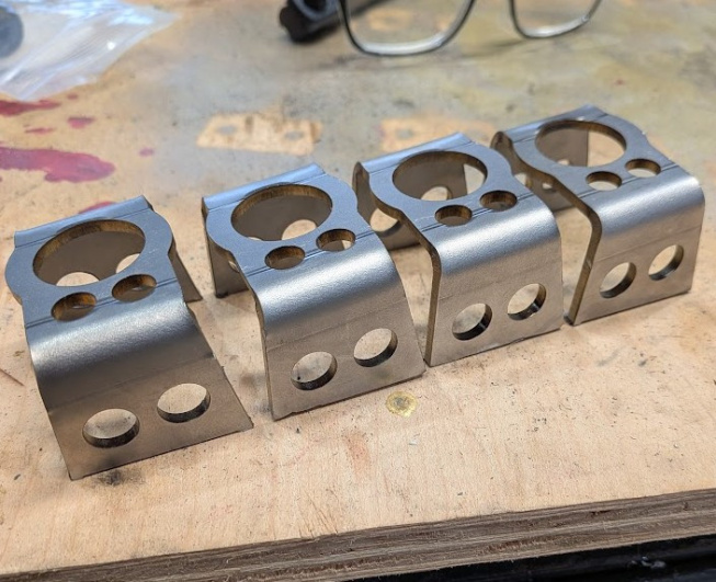

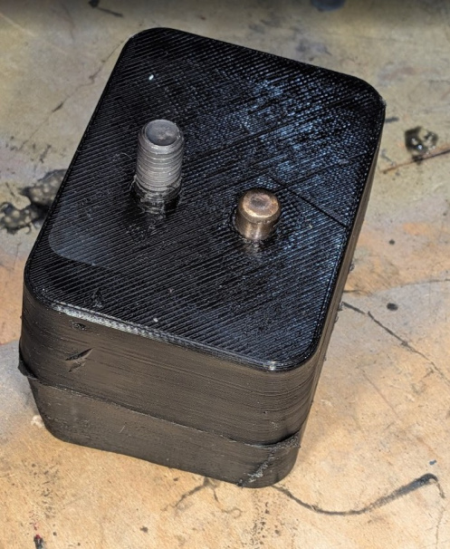

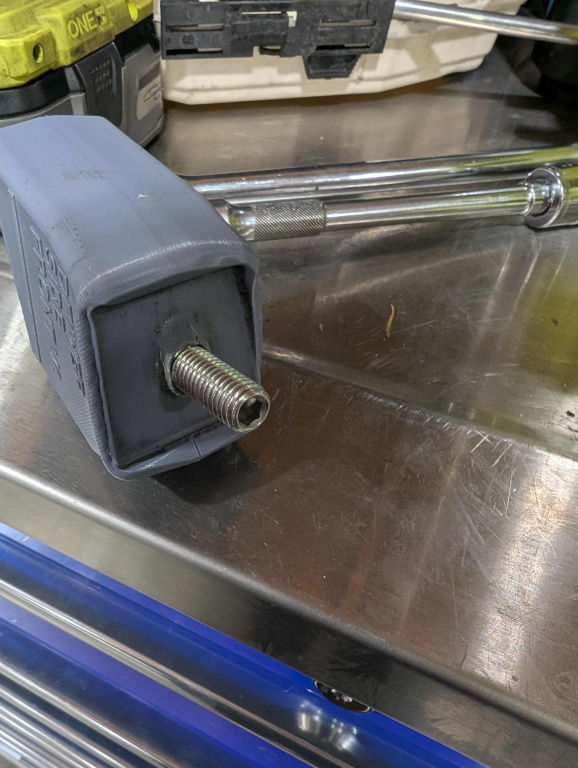

                                My first motor mount is done!
                                I would have had both done, but SendCutSend messed up my order and sent me 4 identical brackets instead of 2 left and 2 right. Anyway..
                                This is what I started with. I thought a vacuum pot was required to do this, but my first one started to gel just a bit as I poured it. The vacuum works great, but it runs-out the clock and I got better results by just mixing, pouring, and straight to the pressure pot. I did phone-a-friend with adam.nonis and he said "this is the way".
                                Click image for larger version  Name:	Screenshot 2025-12-29 175044.jpg Views:	0 Size:	168.5 KB ID:	10153302
                                One of my 3D printed molds, my offset mount and an AKG mount. The top is shifted back 7.5mm and the bottom is shifted forward 7.5mm, for a total of 15mm of rear offset.
                                Click image for larger version  Name:	Screenshot 2025-12-29 180459.jpg Views:	0 Size:	157.8 KB ID:	10153304
                                It's infinitely easier to remove mounts if it doesn't have two studs, so the top is a bolt. This is right after de-molding, which was much easier than I thought. I used release spray and I tapered my molds 5 degrees. They popped-out like biscuits in the oven!
                                My sprues could have been 10mm taller, they were topped-off when it went in the pressure pot.
                                Click image for larger version  Name:	Screenshot 2025-12-29 180940.jpg Views:	0 Size:	161.9 KB ID:	10153305
                                Super tidy! I used Shore 60A urethane instead of 70A urethane that AKG uses. My thinking is that I have LOTS of pieces on the inside that constrain movement, plus the overall size still gives it lots of stiffness.
                                Click image for larger version  Name:	Screenshot 2025-12-29 180429.jpg Views:	0 Size:	161.3 KB ID:	10153301
                                I was supposed to get 2 leaning left and 2 leaning right...
                                Click image for larger version  Name:	Screenshot 2025-12-29 175448.jpg Views:	0 Size:	156.8 KB ID:	10153303
