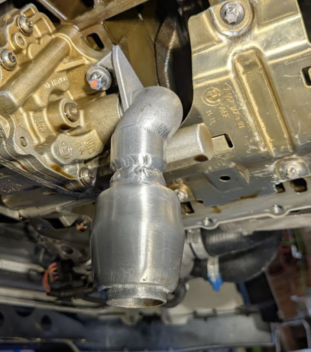

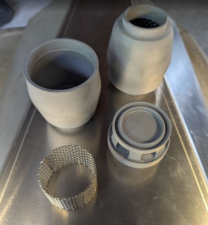

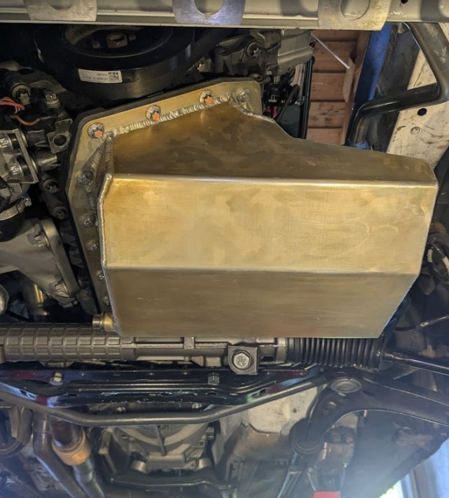

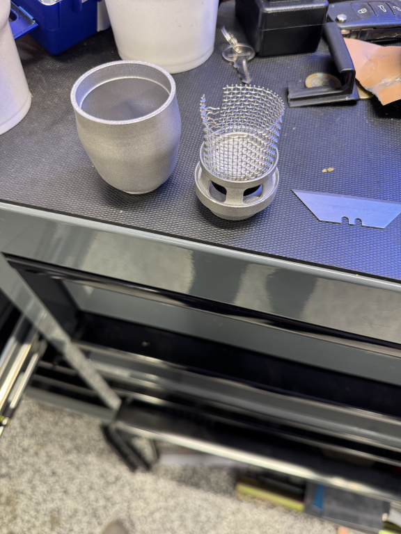

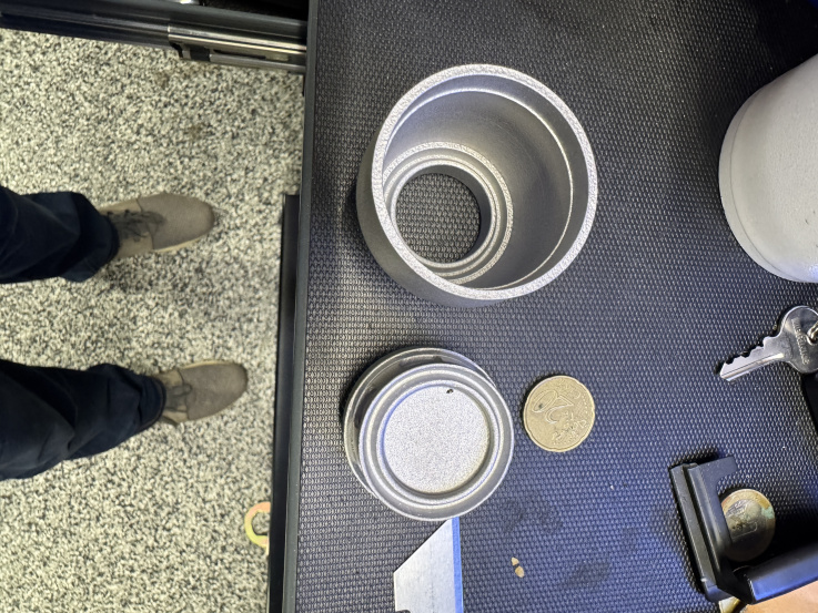

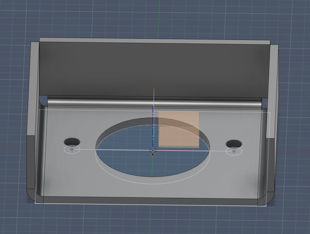

        Final answer for the aluminum oil pan. Some changes on this one, which was now completely cut and bent to reduce welding and increase accuracy. All of the pieces fit GREAT and I there wasn't even 1/32" gap anywhere.
        The pickup is completely 3D printed in aluminum as well as the strainer, which uses a cylindrical screen to give it a small diameter while keeping screen area. This keeps the hole in the top plate small.

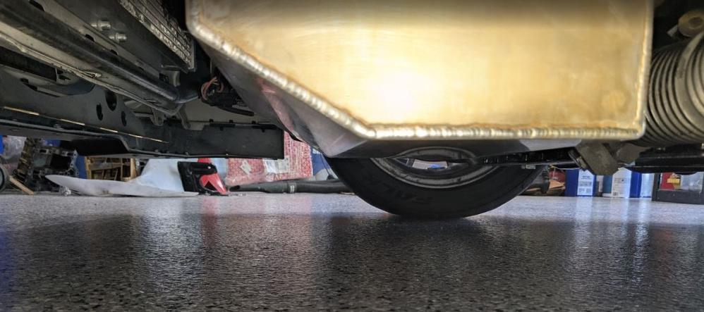

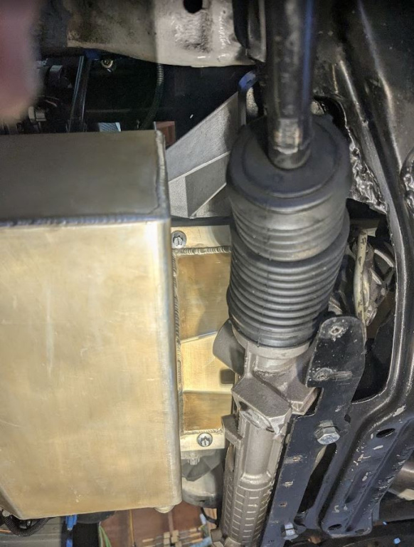

          The finish is Type 1 Alodine.
          Fits great, lots of room at the steering rack means I can eventually move the engine back an inch.
          I have the CAD for all of this, happy to share!

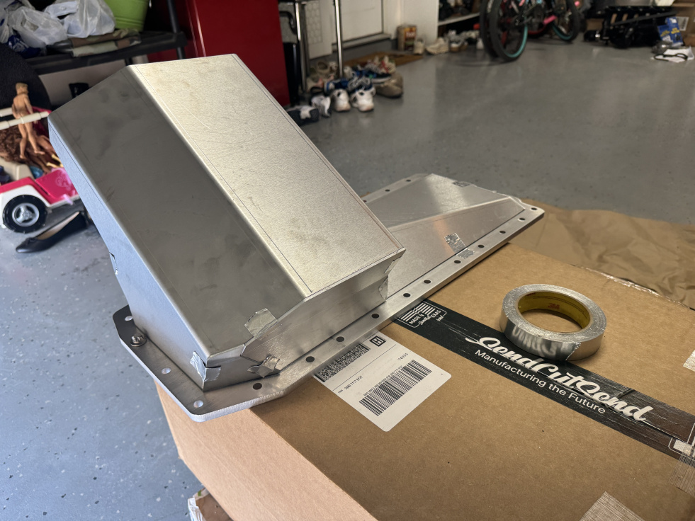

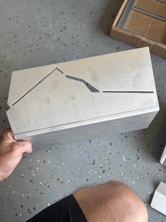

                  #128

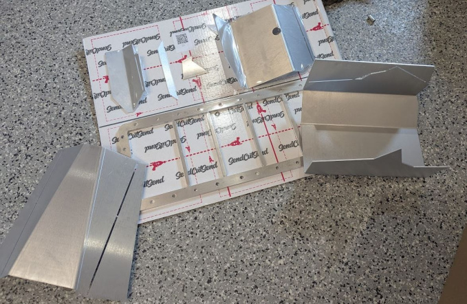

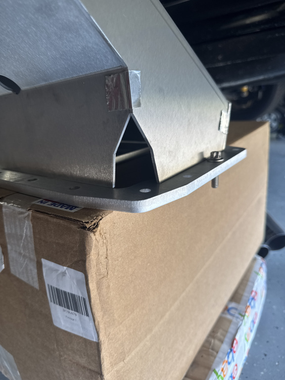

                  Another member had my brother and I assemble hoveringuy 's newest version of his oil pan. Thanks to him for providing the CAD files and some insight on assembly.
                  Here it is fresh from SCS. The bends require a square edge so he designed them into the files, just have to cut along the slits. Keep the remains from the third pic as only one corner on this one needs to be cut yourself.
ID:	10155940 Click image for larger version

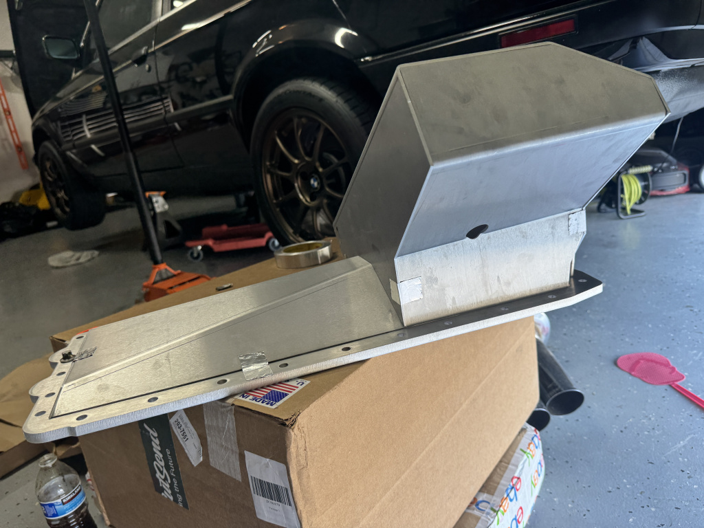

                    #129

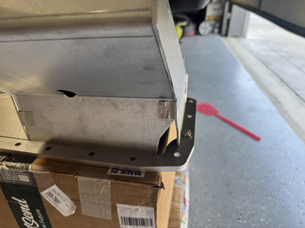

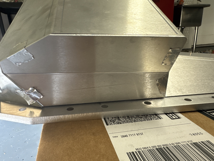

                    Here it is taped together for a test fit.

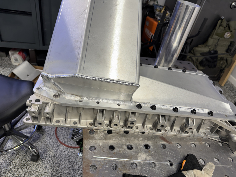

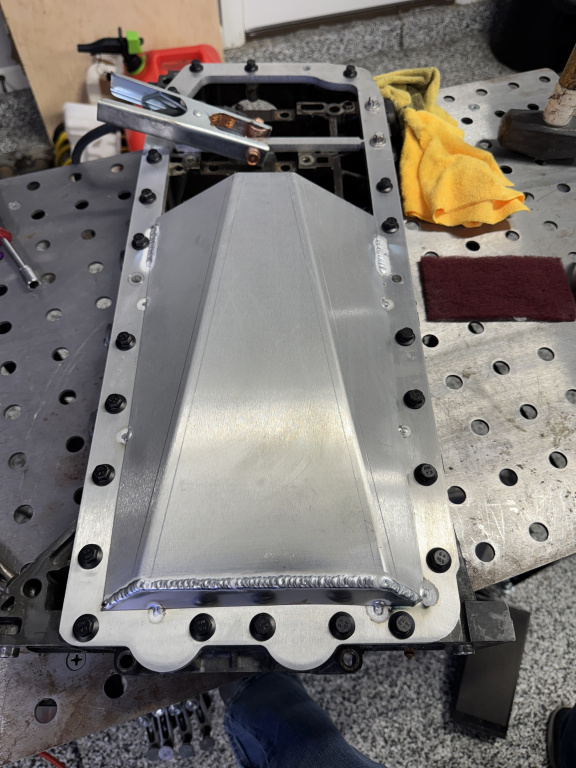

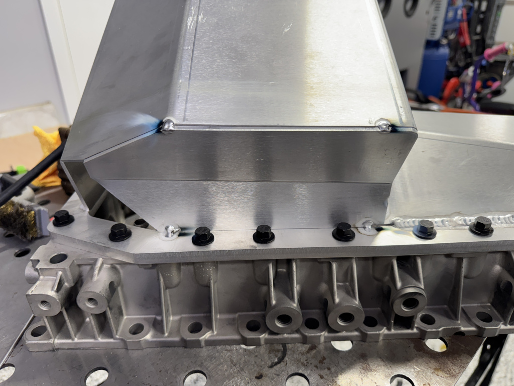

                    • Striker01
                      • Jul 2011

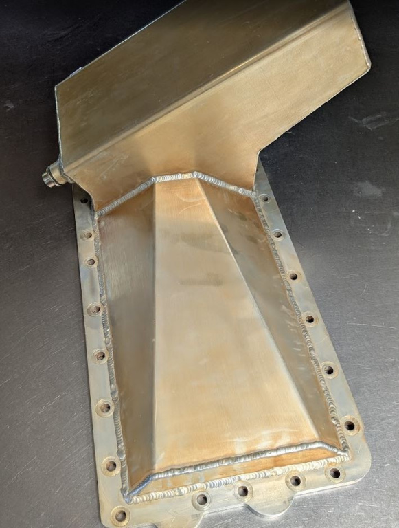

                      • 375

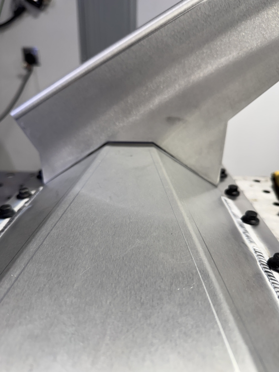

                      #130

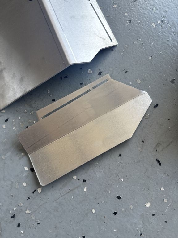

                      This is the only corner you have to fab yourself, from the cut off extra.
                      Click image for larger version  Name:	IMG_2398.jpg Views:	0 Size:	134.9 KB ID:	10155952
                      Click image for larger version  Name:	IMG_2399.jpg Views:	0 Size:	226.1 KB ID:	10155950

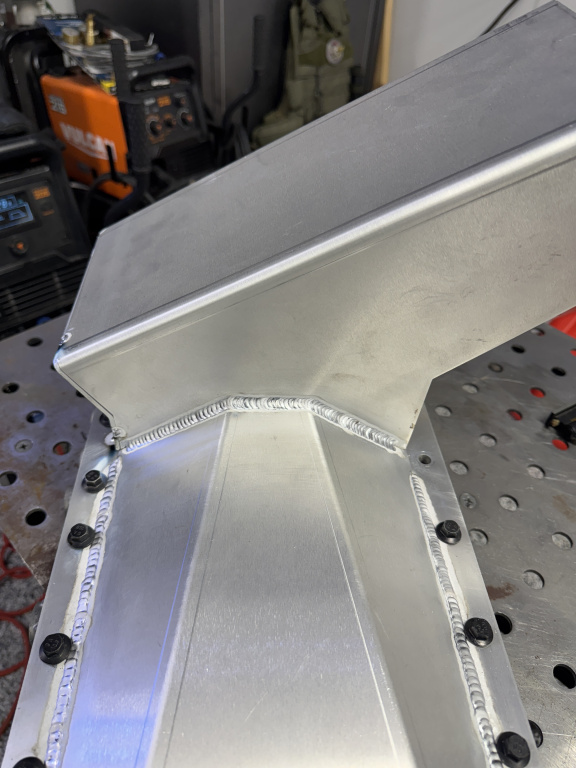

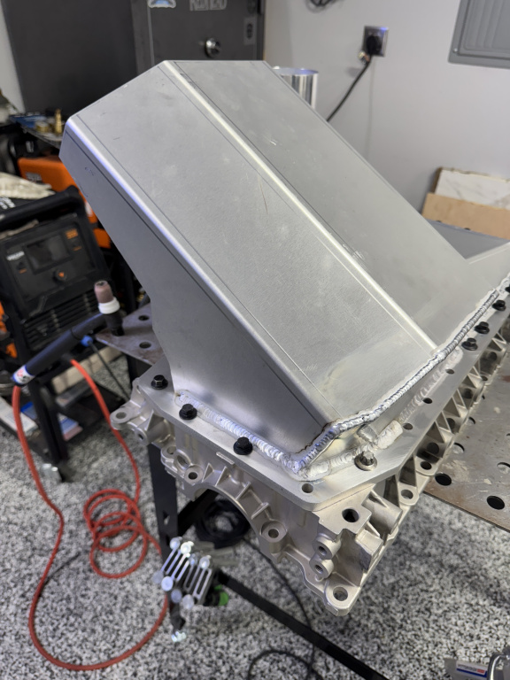

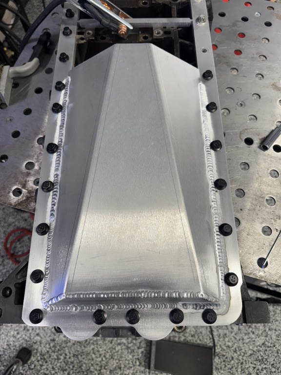

                      We started by welding on the back main piece to make sure the rear piece doesn't protrude inside the flange.
                      Click image for larger version  Name:	IMG_2444.jpg Views:	0 Size:	190.6 KB ID:	10155953 Click image for larger version  Name:	IMG_2443.jpg Views:	0 Size:	196.7 KB ID:	10155954
                      We made a mistake here. One of the rear main tacks popped during welding and I had to hold it down while my brother re tacked it. In hindsight we should've tacked the main pan piece before fully welding this. You can see in the pic below that I pushed it down just a little too far but didn't realize it until it was fully welded, not a bit deal but required trimming the main pan a little. That gap looked a little big to try and fill. (I know, that's what she said)
                      • Striker01
                        • Jul 2011
                        • 375
                        #131
                        This thing pretty much fit together perfect, very little adjustment required.
                        Click image for larger version  Name:	IMG_2448.jpg Views:	0 Size:	258.6 KB ID:	10155961
                        Click image for larger version  Name:	IMG_2451.jpg Views:	0 Size:	167.2 KB ID:	10155959
                        Some hammering on this front corner to ensure bolt clearance.
                        Click image for larger version  Name:	IMG_2450.jpg Views:	0 Size:	265.9 KB ID:	10155957
                        Click image for larger version  Name:	IMG_2449.jpg Views:	0 Size:	185.7 KB ID:	10155962
                        Click image for larger version  Name:	IMG_2447.jpg Views:	0 Size:	148.0 KB ID:	10155960
                        At this point I recommend fully welding as much of the inside flange that you can get to, before you cut the ribs out of it.

                          #132

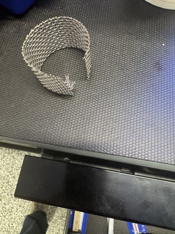

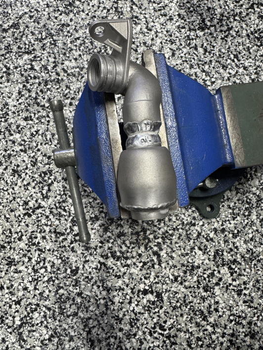

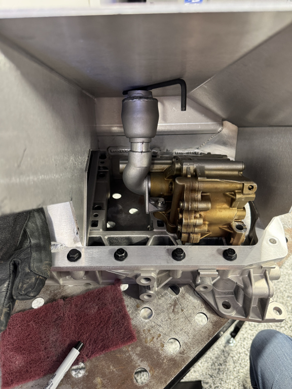

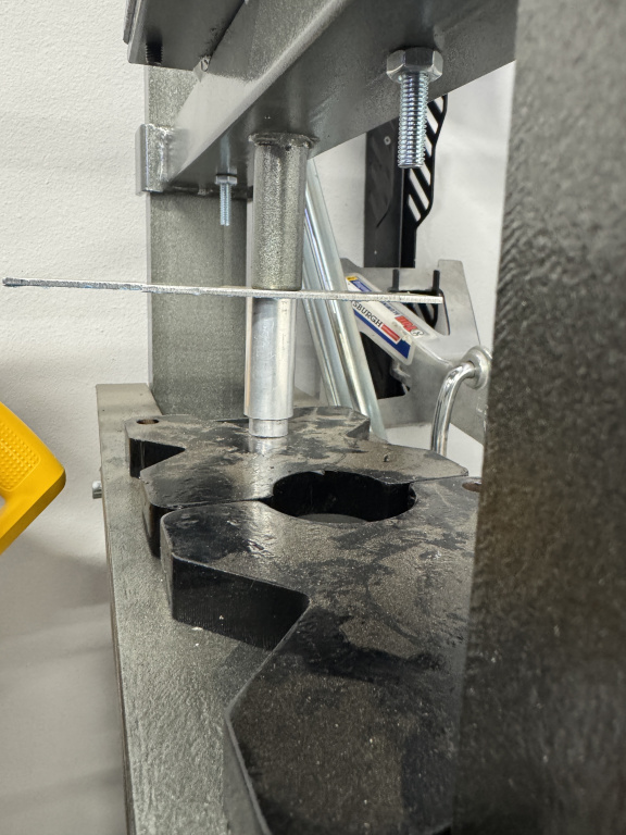

                          Next it was time to assemble and check fitment of the 3d printed (super cool) oil pickup, 1 or 2 of the support ribs will need to be cut out for this step. It comes in 3 pieces and requires some stainless steel mesh, that hoveringuy supplied and even included the dimensions for.
                          Click image for larger version  Name:	IMG_2455.jpg Views:	0 Size:	266.2 KB ID:	10155966
                          I bent the ends through the other piece to hold it together for welding, probably not required but I figured it couldn't hurt.
                          Click image for larger version  Name:	IMG_2452.jpg Views:	0 Size:	275.8 KB ID:	10155967
                          Flip the piece on the left over and weld it together, after ensuring the mesh is seated in it's seat. I struggle with this a couple times before I decided to interlace them.
                          Click image for larger version  Name:	IMG_2456.jpg Views:	0 Size:	188.8 KB ID:	10155969
                          Finished and ready to be connected to the other piece. IIRC a short piece of 1" OD tubing is required to join them together. These pieces did require a little sanding to get the tubing to slide in.
                          Click image for larger version  Name:	IMG_2454.jpg Views:	0 Size:	251.4 KB ID:	10155968
                          I used a 4mm allen so set the height, figure with the gasket is should be right at the 4-6mm clearance required from the bottom of the pan.
                          Set it, mark it, remove and weld.
                          Click image for larger version  Name:	IMG_2457.jpg Views:	0 Size:	188.7 KB ID:	10155970

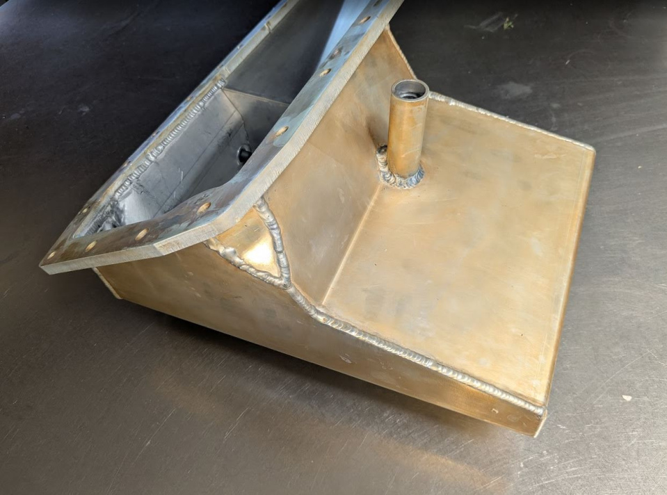

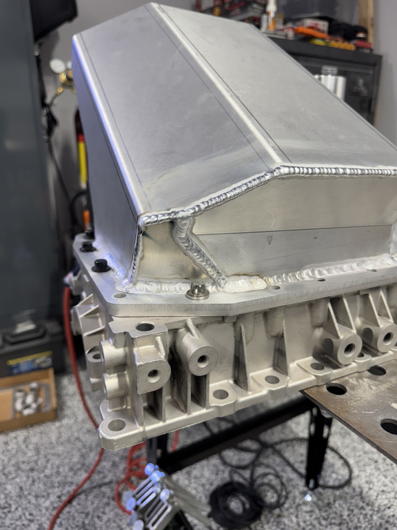

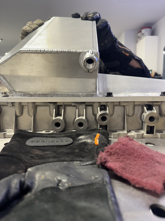

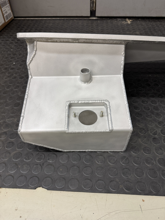

                            #133

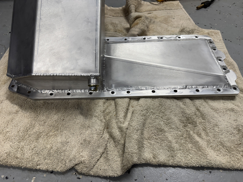

                            Finished product.
                            Click image for larger version  Name:	IMG_2458.jpg Views:	0 Size:	308.8 KB ID:	10155975

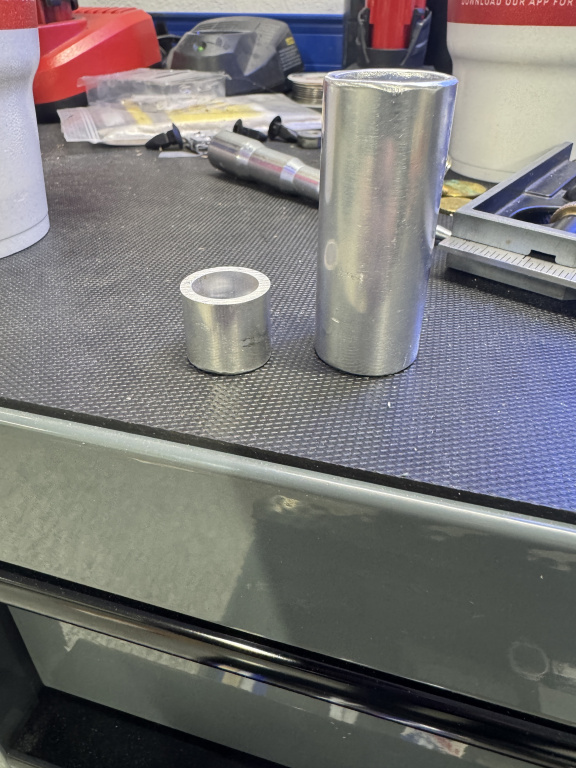

                            This is a piece of 15mm ID x 20mm OD tubing that was pressed into a 20mm ID x 25mm OD tube for the dipstick seat. Once is was pressed in, I drilled it on a drill press with this tool
                            https://www.amazon.com/dp/B00FXJB912...fed_asin_title
                            to ensure it was round for the dipstick.
                            Click image for larger version  Name:	IMG_2496.jpg Views:	0 Size:	196.6 KB ID:	10155974
                            Weld it to the main pan top piece, make sure it doesn't protrude more than about an 1/8" below or you will have issues sliding in the baffle. Then weld on the top.
                            You can also see the one corner that has to be fabricated, we used 2 pieces to make it easier.
                            Click image for larger version  Name:	IMG_2504 2.jpg Views:	0 Size:	173.0 KB ID:	10155972
                            Once that was done my brother fully welded as much of the inside of the pan that he could get to, main flange is the most important as you will have to clearance some of the flange welds for the pan bolts to fully seat.
                            Don't forget the M18 x 1.5 bung for the drain plug.
                            Click image for larger version  Name:	IMG_2460.jpg Views:	3 Size:	149.2 KB ID:	10155973

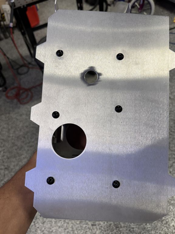

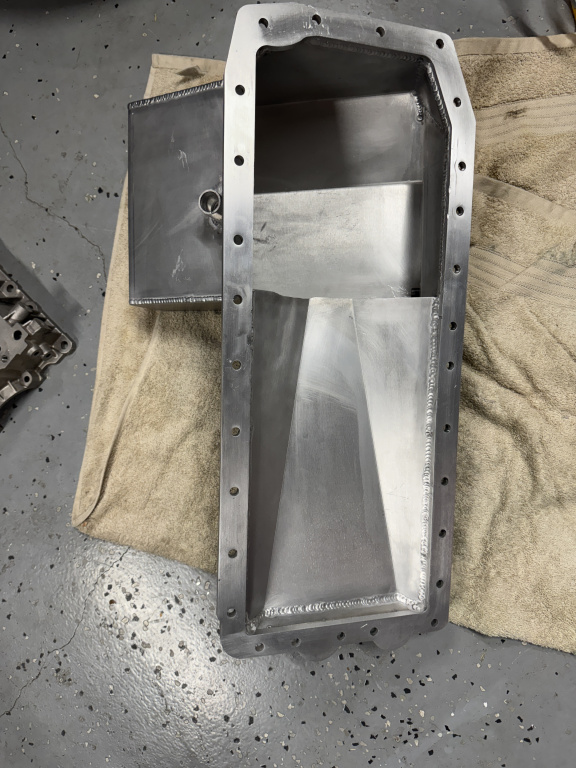

                              #134

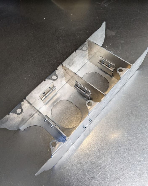

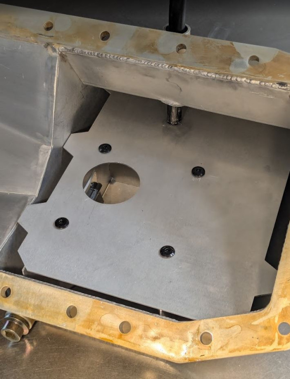

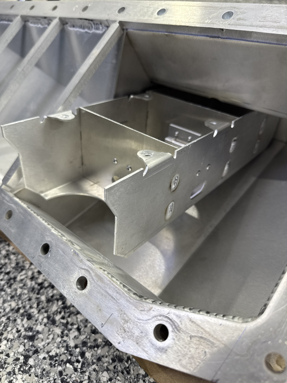

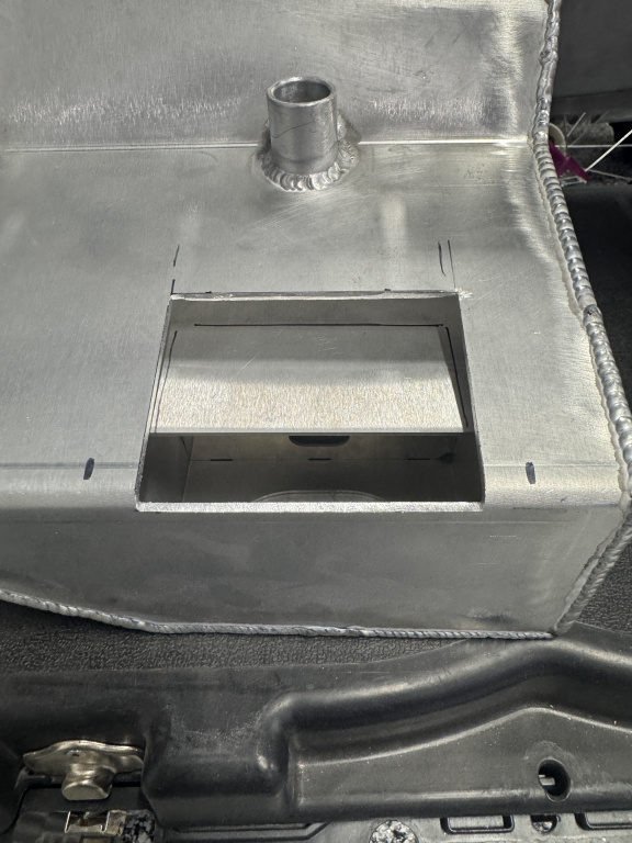

                              The main baffle piece will require some adjustment to fit, this was by design because every pan will come out just a little different and Steve wanted it fit nicely. The key is to sneak up on it.
                              Once that piece fit correctly, I bolted on the top, marked the dipstick location and drilled a hole for it.
                              The dipstick confused me until Steve told me to cut the top on the tube off . I don't have any pictures but you can't get the dipstick far enough into the pan and still get the baffle in, the seat would need to be below the top piece. The solution is to set the seat where it needs to be for the baffle to fit and then cut off the top of the dipstick tube until the dipstick full mark is even with the top of the baffle. Then use a flaring tool to expand the top so the dipstick handle o-rings will slide in.
                              Few more pics after pressure testing and cleanup. You can see why the flange needs to be fully welded on the inside, bolt clearance required cutting back some of the outside welds significantly.
