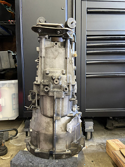

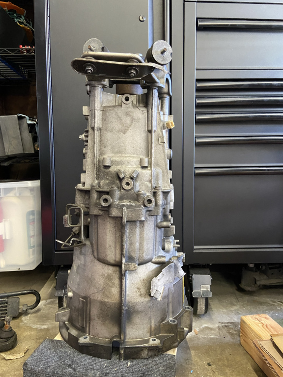

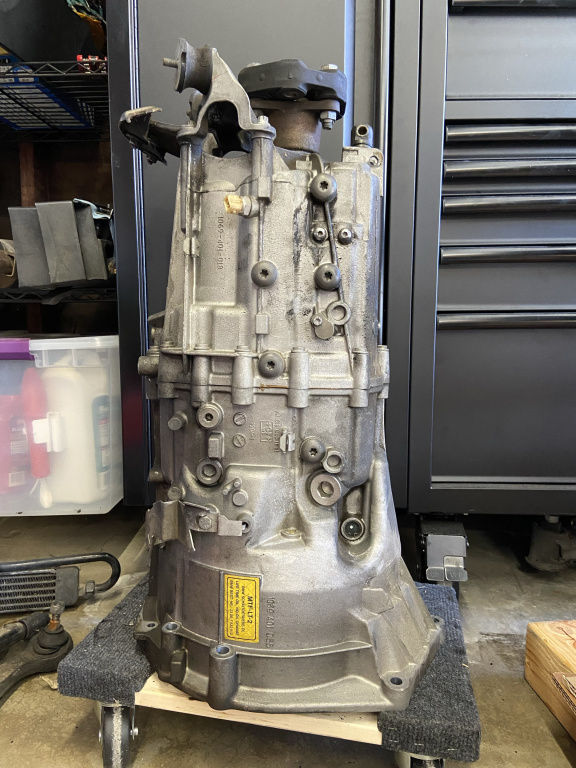

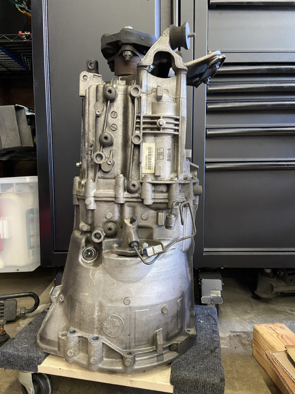

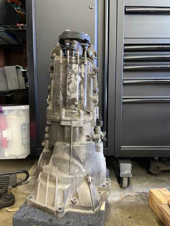

                          Just to add to the list, I pulled this from a 2006 330i in the US.

                          Per VIN / chassis code (VB33) on realoem, it is 23007565853 / GS6-37BZ - TJEP.
                          I don't see any obvious stamping or labels with these numbers though.
