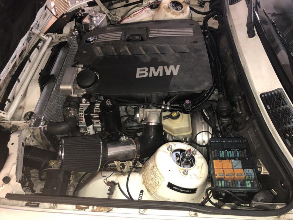

  • cwlo
    replied
    Cover is off of a 2011 528i. Guess they changed it at that point. Even has a roundel in it like the hood badge..lol.

  • nando
    replied
    Which engine cover is that? N54?
    I want to do something with the magnesium cover (powdercoat? polish?), and hopefully fit the S54 throttles with a custom (or CSL) airbox. I just never liked the fake plastic covers on newer BMWs, but I like the fitment/execution of yours.

  • cwlo
    replied
    Here are a few pics. Still need to finalize the wiring and a few other bits, but mostly complete.
    I will do a write up of the whole swap while its still somewhat fresh in my head. What is the best way to create a fairly long thread on this forum?

  • DesertBMW
    replied
    I would like to see engine bay photos
