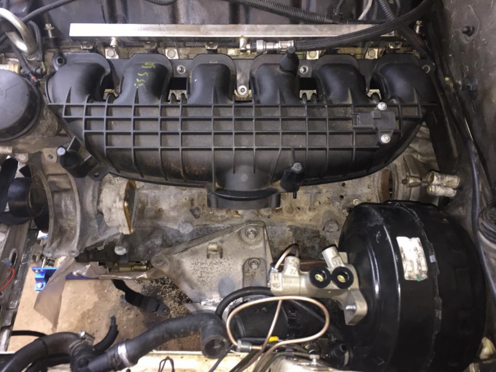

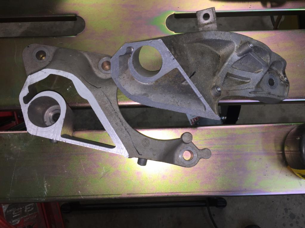

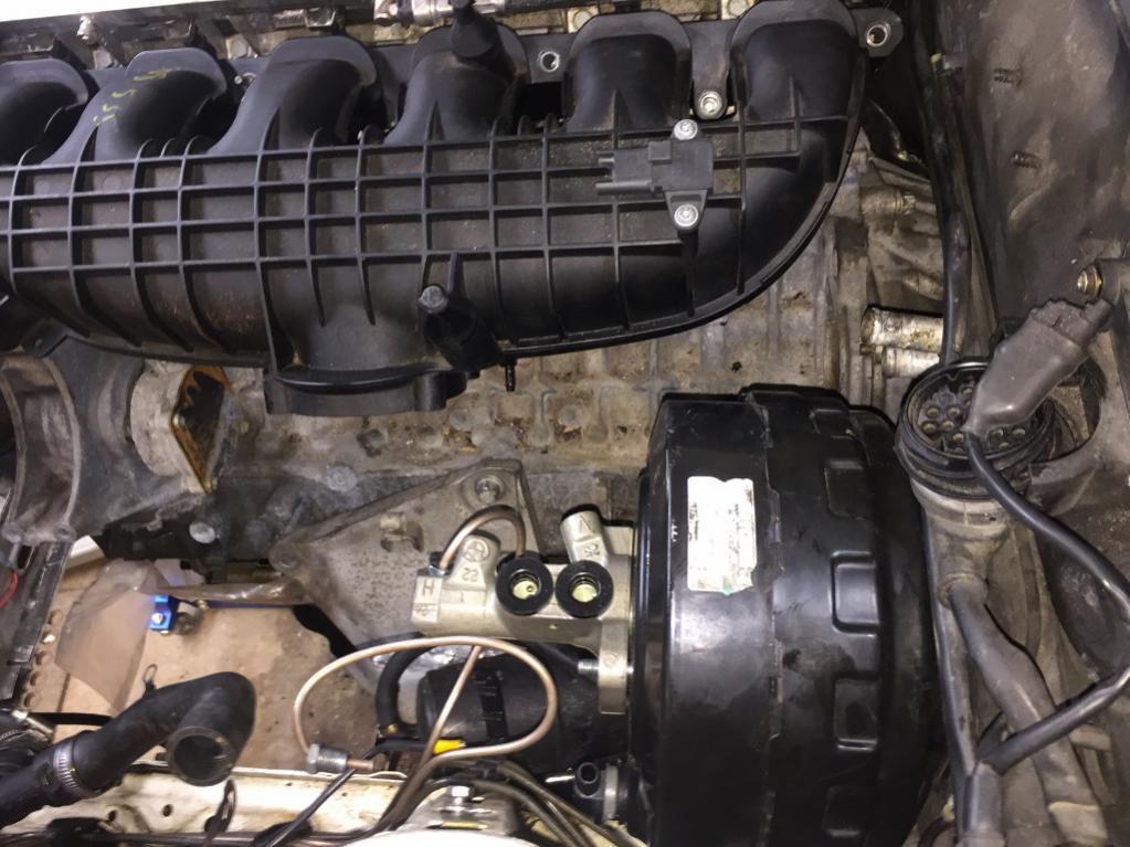

    So, I sliced the engine mount brackets, and then shifted it 1" and then re-welded. I opted to move the engine back 1" and leave the height alone. With some additional bracing, it might be good enough, although the cast aluminum is a bit weaker when welded. I'll probably fab something new later down the road, but for now, it works for sizing and all.
    So with the engine installed with those mounts, and a bolted to the trans in the car to be sure I have the engine at the right angle, this is how it sits. With the N54 intake (which is a Godsend), there is a ton of space. I have an e90 booster and MC loosely placed for the pic. Will probably sit another 1/4" back when bolted. Although the pic doesn't do much for depth perception, it will work fine, and also look at the nice room by the heater inlet/outlet.

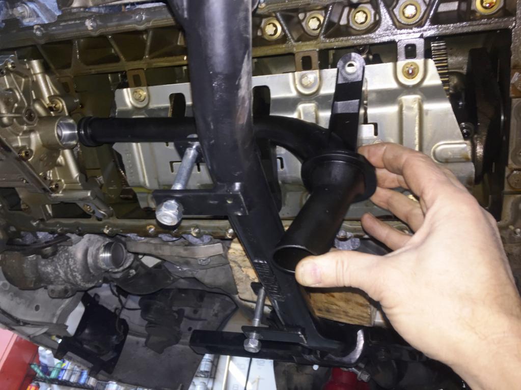

    So, I then snapped a pic of the oil pickup. It needs to sit right where the arc asylum tube is, so I will have to fab up a modified tube and pan. I'll take a few pics of the oil pickup, and post them for suggestions. I'm thinking I can turn a piece of steel to duplicate the size and shape of the stock end, and then weld an m54 pickup to it to get the right length. I have no experience modifying plastic, and with such a critical piece, not sure I want to take any chances.
