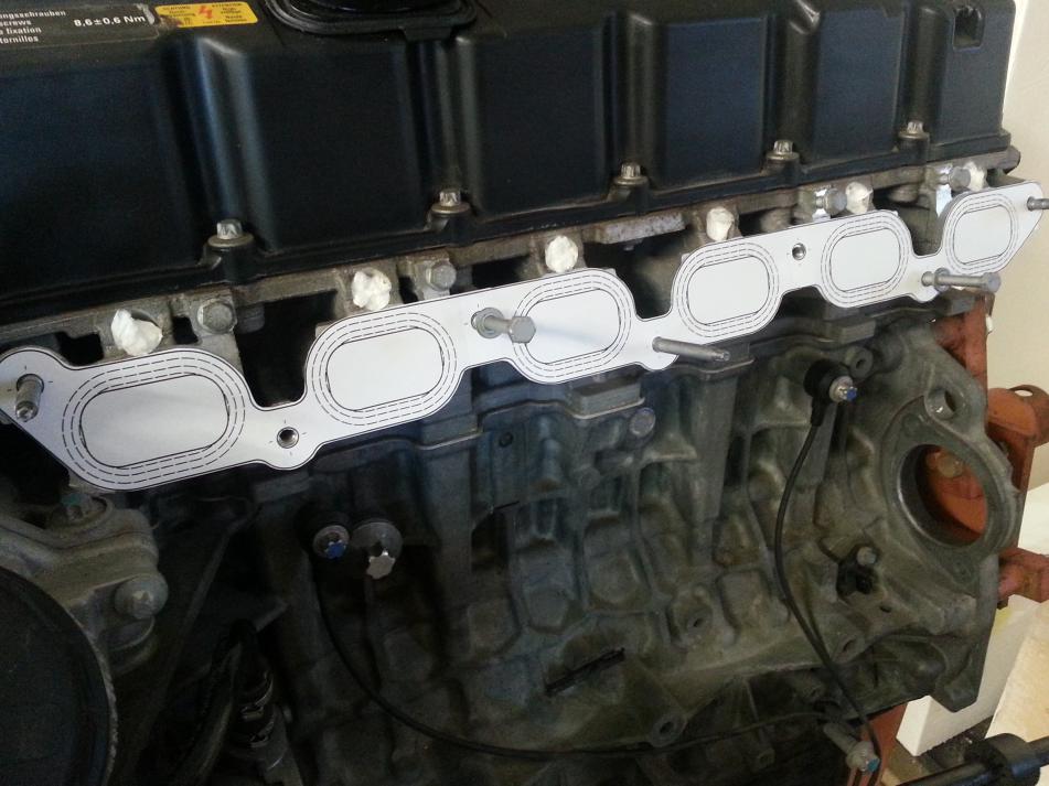

              Here's an aluminum tube for extending the oil pickup tube.
              I finally took the oil pan off today. Then I unfastened the bolts holding the oil pickup along with a couple others. I then relocated the pickup tube to the holes toward the rear of the bedplate. Had to swap some screws around because of different lengths. Then I held the oil pan back up to the block and there was an interference that didn't allow the pan to sit flush by about 3/16". I determined it was the bottom of the pickup tube. I trimmed roughly 3/8" off the bottom and reinstalled everything. Seems to fit fine with no interference detected. Once I reach the point where I'm ready to cut into the pan, I'll see what kind of clearance remains between the pan and the bottom of the tube.
              So anyways.... The distance between the bolts for the pickup tube is 91mm. (Coincidentally that's the same distance between the bolts that hold the intake manifold on the head.) By moving the tube assembly over by one set of holes, I needed a tube to make up that difference. I just modeled the end of the plastic piece and took a couple measurements of the oil pump bore. (30mm dia.) Here's a print of the part. I haven't machined it yet. Could be awhile because of.....
              I also have been working on a spacer for the mismatch between the N54 manifold and the N52 head. The spacer is 3/8" thick (10mm) and longer 60mm bolts will be needed to make this work. I couldn't find any 7mmx60 studs anywhere,
              so bolts are the 'only' choice. Not sure if this piece is really necessary, but I have the parts and the time, so I ended up with this.

                It's not a coincidence - the cylinder spacing of every BMW "small" 6 since the M20 is 91mm. :)

                  #158
                  Originally posted by nando
                  It's not a coincidence - the cylinder spacing of every BMW "small" 6 since the M20 is 91mm. :) .
                  They couldn't get an even 90mm huh? ;-)
                  I plan to make the spacer out of aluminum plate. If you look closely at the mock-up.... The dashed lines represent the 'o-ring' groove on the back side. OEM gaskets will fit there. I 'smoothed' the transition between N54 and N52 with a 10 degree draft angle. That way it could be machined with 'off the shelf' tools and not need 3D machining. Just a 10 degree tapered endmill.

                      #160
                      I was originally going to design it to be thinner. But 55mm length bolts are not a 'normal' thing. The other factor was the off the shelf tooling and the 10 degrees is perfect for the difference in profile over the 3/8" distance.
                      The N52 head port is a little less narrow on the top and bottom compared to the N54 manifold. About 1mm per side. There would be a step, and the air would 'tumble' I believe. Perhaps insignificantly. I just thought 'smoother' would be better.
                      I think the velocity may decrease slightly because the N52 opening has a bit more surface area. Perhaps by smoothing the transition, the 'negative' effects are reduced or nullified?

                          #162
                          I found an error with the pdf I posted yesterday. I previously made the part 91mm OAL. But it needed to be 91mm from the o-ring end to the bottom of the counterbore on the opposite side.
                          Things like this are why there are usually more than one person in an engineering team. Also, why I'm reluctant to share this stuff until I've tried it out for myself.
                          Here's the corrected pdf. I edited the above post and changed the pdf there too. I just didn't want any confusion.

                              #164
                              RE: M7 x 60mm studs
                              would something like these M7 to M8 studs work? May need to increase the hole size in the manifold
                              https://www.wemoto.com/parts/picture/ho-90035-mj0-920
