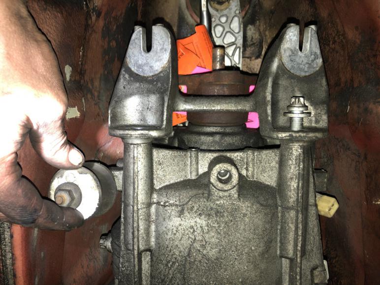

        I have to built the transmission mount while the engine and trans is in the car... I won't have a transmission attached to the bare block while I'm mocking up the engine arms. This also means I won't "discover" that the trans has moved while I'm nudging the engine around getting the location correct. I don't have a factory E30 manual trans crossmember (well, a spare one... I'm not going to pull it off my driver), but the combination of the longer length of the 6 speed and the bolt-on e90 bracket shown here mean that the rubber trans mounts are way further back than the e30 floor pan allows... you start to get into a much more complicated mount location. My solution to this is to re-locate the trans mounts either side of the trans where they *barely* fit and build the mount forward from a flat plate. This also gets us clear of the output flange so guibo bolts aren't tricky to access. Will this be a catastrophe? I don't know... but it'll hold the trans it the right location for now.

        Here's a new crossmember built to give a flat reference for the trans mounts. I know they're angled in the original configurations... but I thought about it really hard and I can't think of a great reason for it. Even if there is... it's going to be very slight and this really simplifies the bracket. If I end up a little high, this can be dropped down with spacers from the body. It looks like a big ugly piece, but it actually tucks up higher than the trans drain plug.
        Here's that bracket tacked together. The trans plate is 10ga, which is woefully inadequate for use in the car, but fine for mockup because those pieces can "grow" in one direction without affecting the faces they mount to. I didn't have a big enough piece of 3/16 for the rear plate handy, and I thought it would be better to see everything bolted up with some weight on it.
        Here's the pieces installed. There's so little weight back here that you can push the trans up with one hand about a half or 3/4 inch before it hits the tunnel:
        There's a few changes I'd make to this... the mount ears need to move down to give better clearance between the trans and the crossmember, the ears can get a little shorter to move the crossmember back (and further up the taper of the webs on the trans giving more clearance) and the rear plate can be cut down a lot for clearance.

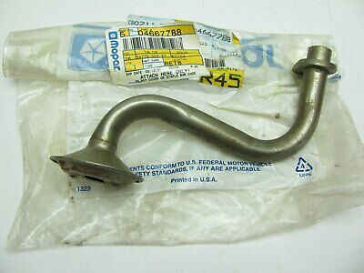

            are you having these cut with a laser / water jet? what's your plan for the oil pickup tube?

              #111
              Yea, I have a quote for laser cutting that sounds reasonable, but I’m going to print the flange out on paper for a quick reality check.
              Honestly the price for the cutting is super competitive compared to the retail cost of plate. I figured why not give it a shot.
              I dont have a plan for the pickup yet apart from expecting it not to be a huge hassle. It’s not a pressurized connection... it’s just a push-in with an o ring that gets fixed with some standoffs. I’m hoping to find something that’s adaptable maybe with a turned piece to fit the pump. The pickup itself can be any screen and puck... the cheapest route seems to be a junkyard or ebay pickup from a different vehicle that can be shortened. I have a Dodge Ram pickup that looks something like the attachment floating around here somewhere that I thought might work.

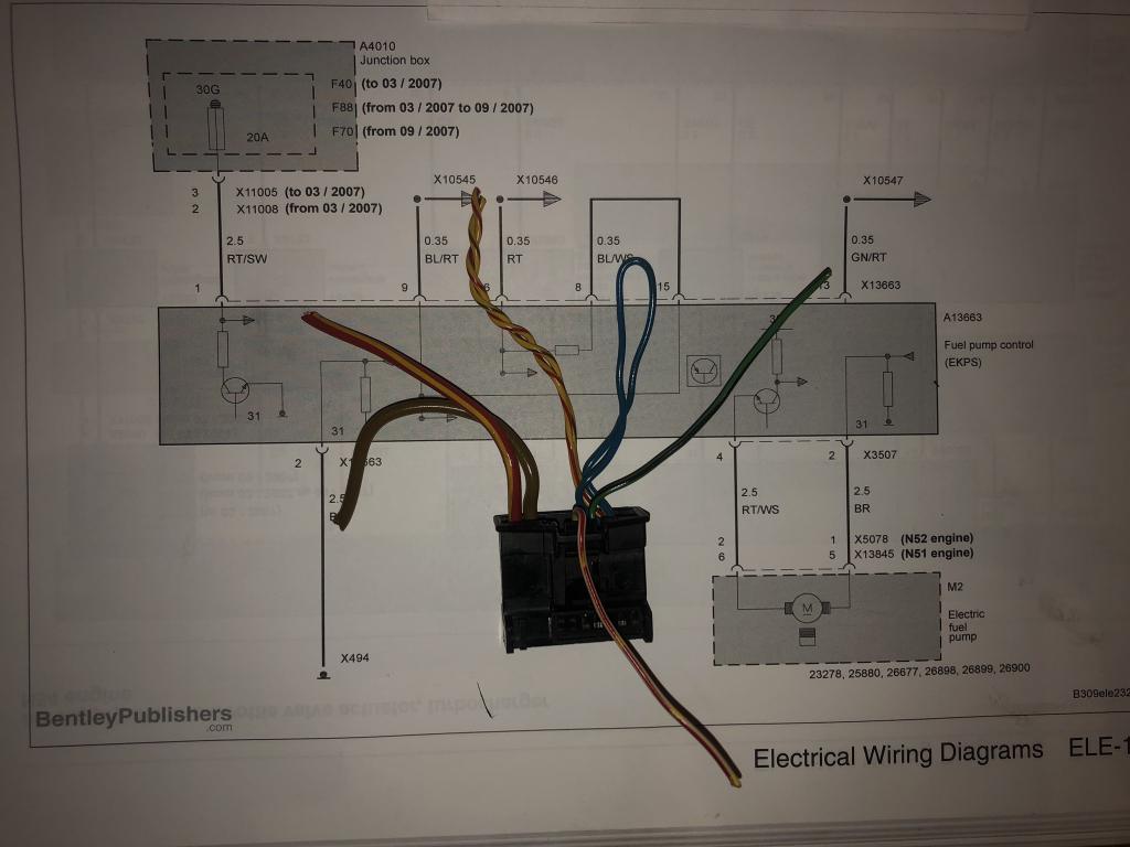

                On the off-chance that someone has the Bentley for the Z4 (or there’s a better ETM for e90’s) id love a copy of the EKP diagram. I picked up a 16146766003 module with pigtails and I have an extra wire and the colors on my pigtail are different compared to the e90 diagram. I assume pin 13 is still a k-bus to disable the fuel pump in an accident and can be left floating (it doesn’t need an “I haven’t had an accident” signal) but I also have a mysterious pin 12 which is white with a red stripe and yellow dots.

                  #113
                  There’s a reference in another forum that the EKP also has switched ignition? Not on the e90 it doesn’t... maybe that was a change to get fuel pressure faster while the other modules booted up?

                    #114
                    the old TIS (which replaced the ETM) doesn't work in modern browsers anymore, but thankfully somebody has updated it:
                    https://www.newtis.info/tisv2/a/en/
                    https://www.newtis.info/tisv2/a/en/e...module/XhflKCR (description)
                    https://www.newtis.info/tisv2/a/en/e...module/qJ5aaO8 (Z4 diagram)
                    https://www.newtis.info/tisv2/a/en/e...module/pdjfLrw (E90 diagram)
                    The only difference I can see is the Z4 uses DCAN (can11h mode) and the E90 uses PTCAN (BN2000 mode). The pins are nearly identical otherwise (only the connector names differ, and the wakeup signal is different) The Z4 would have to have a different flash because can11h and BN2000 are not compatible (BN2000 is faster and carries more data, but isn't important in this case).
                    the "WUP" (wakeup) signal on the E90 is controlled by the CAS system, but you can just replace that with switched ignition, it does the same thing except of course the E30 doesn't have much in the way of anti-theft systems. The Z4 doesn't look like it uses that (I haven't followed pin 12 to see where it goes).

                        #116
                        It’s so much easier clicking around connectors instead of searching the diagrams for the same number. Thanks for directing me there.
                        there’s definitely a pin out difference between these modules. My diagram above was from a 330i and has the K-bus connection to a passenger floor module for crash detection on pin 13... the Z4 does the same thing but on pin 12. The X3 (which is where this module was reported to be from, although the model number is identical to the Z4) also uses pin 12, but uses pin 13 for switched ignition:
                        https://www.newtis.info/tisv2/a/en/e...module/nYZ6b1n
                        i guess what I’m expecting is that this module will expect power on pin 13 in addition to the signal from the DME?

                            #118
                            No, that's not what that is. The wakeup signal activates the modules (and in the case of the EKP, it primes the fuel pump when pin 13 is activated) when you open the drivers door, as detected by the CAS. Any data for the different modules is transmitted via CAN, not a specific wire. The difference between the Z4/E83 and the E90 is they have an EWS3 module like the E46, while the E90 has a CAS. The Z4 uses K-CAN to wakeup the module instead of the CAS. There's no pin 13 on the X3 diagram you linked.
                            Both may have the ability to shut it down in the case of a crash, but basically what I'm saying is if you supply power to pin 13 from the ignition switch, the module should power on. Remembering the hardware part numbers for all of these are the same IIRC, but they have different software, due to having different CAN bus networks which are incompatible with each other.

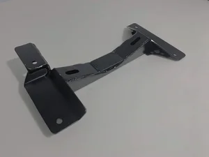

                                #120
                                I swear a while back somebody posted a bolt-on BMW part that would mount the 6-speed to the E30, but it may have been the E46 version instead of the E90. It was like a mix of parts from the Z4 etc.
                                The E90 part shown above will convert the mounts to the Getrag 420 style.
                                Then you should be able to use the Bayside Fabrication brace or similar.
