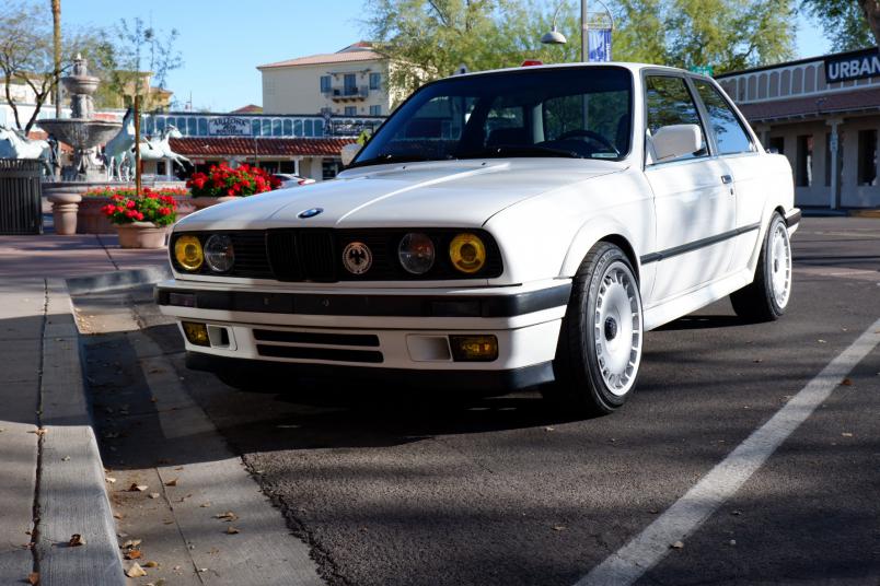

    Long time lurker and getting ready to do my 24V swap. I'll be following the S54 swap that classic daily did a little while ago that retains use of the AWD but swapping a S50 3.0 instead. I'll post pictures as I go and which parts I used to make it all work. I aim to start pulling my engine in the first couple weeks of September if the AZ heat isn't too bad.
    The car is a 91 ix 5 speed coupe in alpine white II
