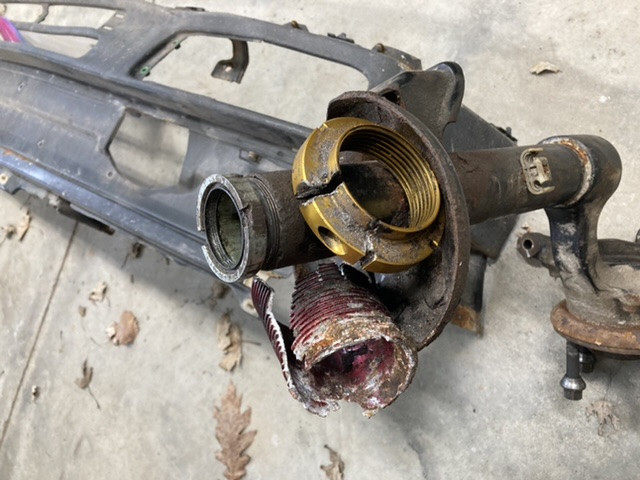

        I was able to get the GC adjuster off of one of my front struts. Dremel cut off wheel, hammer and flat head screwdriver did the trick. No damage to the strut housing!
          jeez, that looks awful. I'm hoping enough lube and heat will do it once I get them out but it doesnt sound promising.
            Texas chainsaw massacre for sure. Good stress reliever cutting and beating on it. No amount of heat or lube would have worked (on mine anyway).
                  I don't know why this picture is so satisfying.
