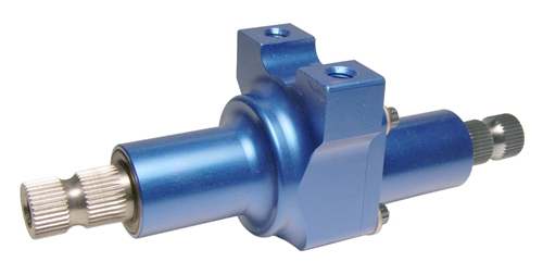

I know somebody who did it, it does work but it also doubles the steering effort.Comment
A 1.5:1 quickener would increase effort by 1.5 times ;)
Who gives a crap? It's still power steering. Instead of the spool valve cracking at 10 ftlbs (or whatever) of steering wheel torque, it cracks at 15.
