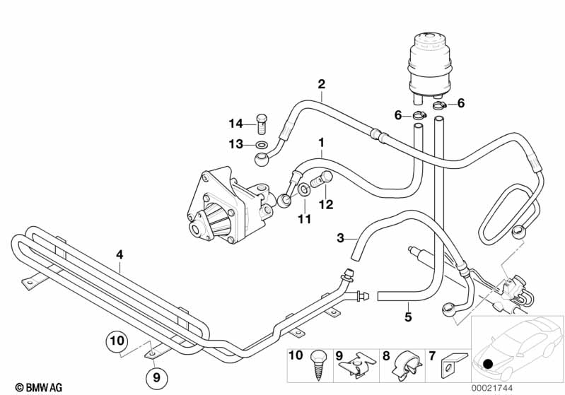

                Cant you just replace it with a brake hard line?

                  The way that's leaking, it's a pressure hose. Sealer won't cut it.
                  Just take the belt off. It'll suck for a weekend, but then you can order a new pipe.
                  http://www.realoem.com/bmw/enUS/show...diagId=32_0267
                  Number 2 in this diagram, maybe?

                    No, the pipe that is leaking is part of the rack.

                    • Nisse Järnet
                      • Aug 2013
                      • 1221
                      Brake hard line? :)

                      • Nisse Järnet
                        • Aug 2013
                        • 1221
                        Oops big picture..
                        Edit: Made it smaller..

                        • barbierij
                          • Sep 2012
                          • 1294
                          thank you for that picture! I was just about to take pictures of my spare. I don't want to drive this to my shop so hopefully I can get to it on ramps. Or maybe I can remove the PS belt for the drive to the shop. Its supposed to snow here tomorrow so sometime this week. I'll update when I work on this.
