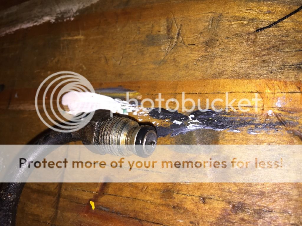

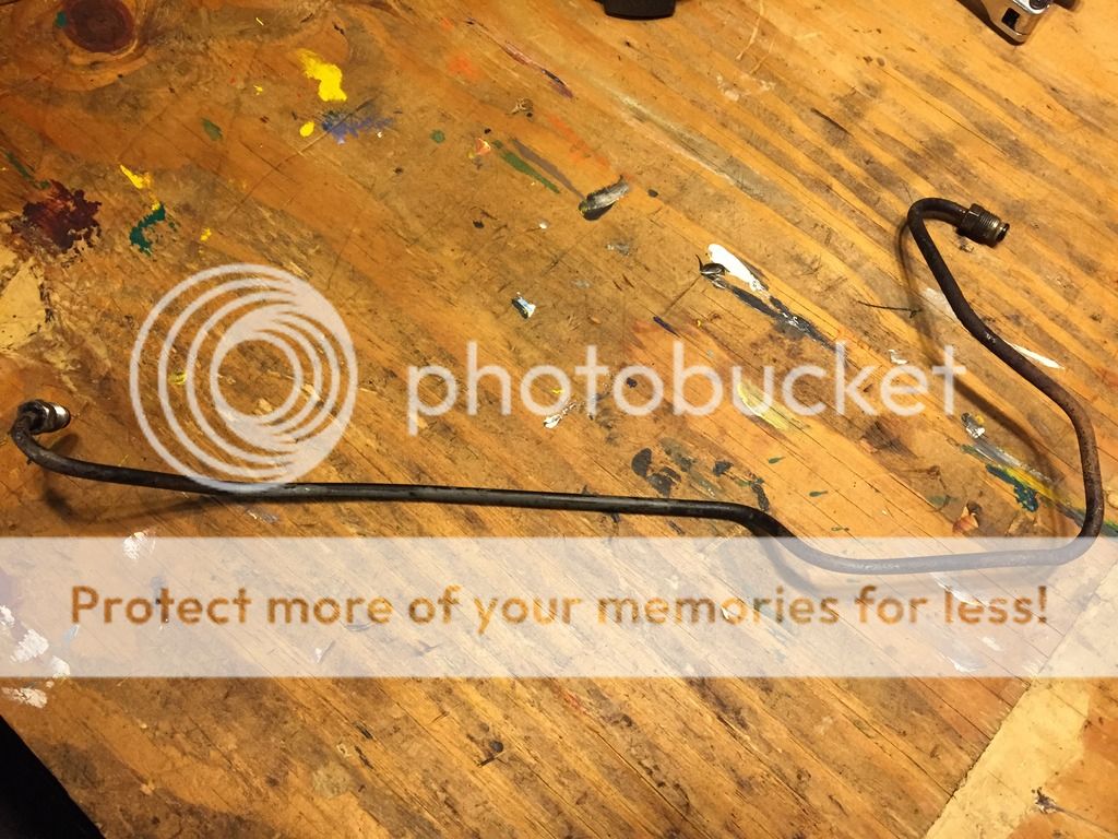

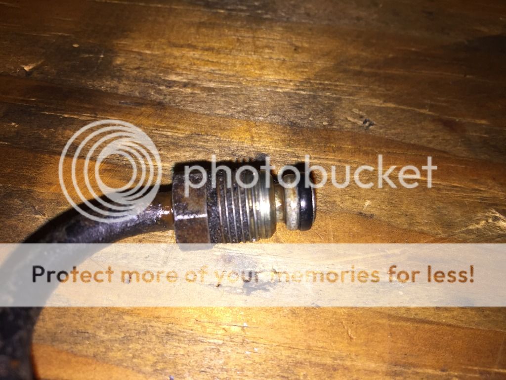

                      So I had some time today with my dad so we put the car on ramps to pull the pipe. What a PITA to get at it when you can only feel and have big beefy arms that barely fit anywhere.
                      The pipe on my spare rack has a little rust on it so I will try to make a new one of these. I have never seen a flare like this one with the o-ring so I will be searching around. Does anybody have contact information for places that reman iX racks? Having four of these cars (one is for sale), I probably will see this problem again.
