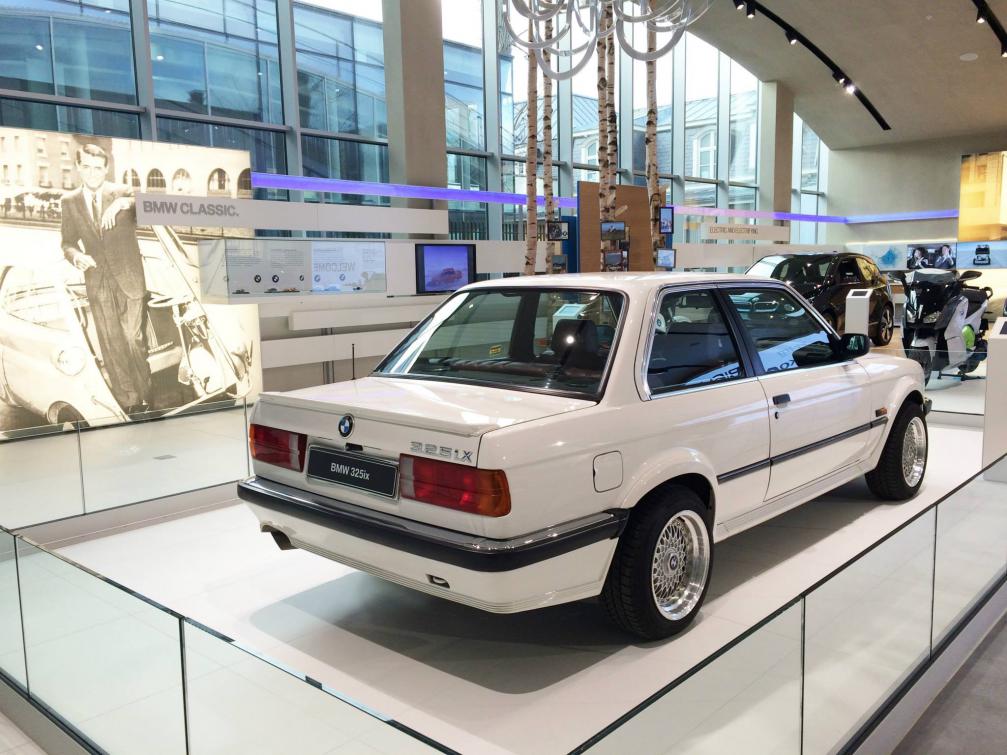

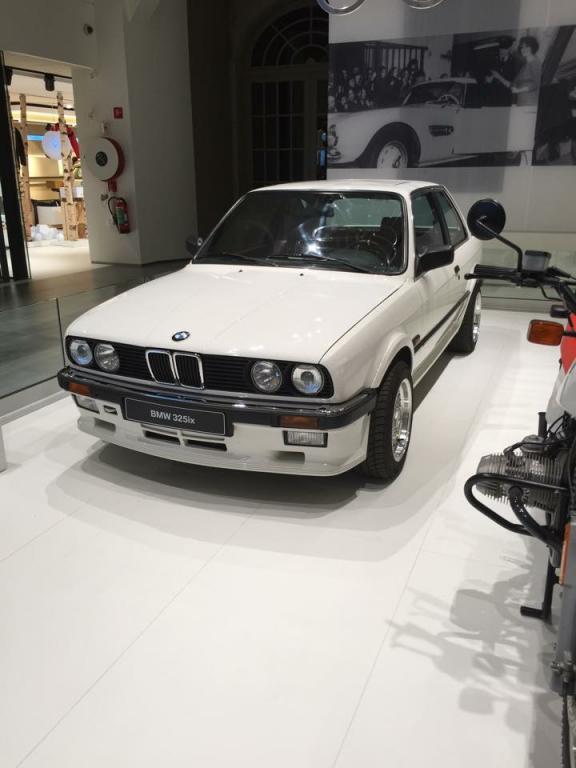

    • tmacbmw74
      • Sep 2014
      • 297
      Oh this is so perfect

      • tmacbmw74
        • Sep 2014
        • 297
        Anther angle

                        • flyboyx
                          • 8371
                          that is indeed a pretty car. to me the wheel/suspension setup is completely wrong. they poke way too far outside the wheel wells, there is too much stretch, the tires are too tall, and the stance is too high almost to the point its painful to look at.

                          • mtnbimmer
                            • May 2012
                            • 73
                            "To me the wheel/suspension setup is completely wrong. they poke way too far outside the wheel wells, there is too much stretch, the tires are too tall, and the stance is too high almost to the point its painful to look at."
                            My feelings exactly.
                            • tmacbmw74
                              • Sep 2014
                              • 297
                              Alright fellas thanks for the advice and I agree on the stretched tires/wheel offsets. My point was more focused on the beauty of the euro appearance over the NA appearance
