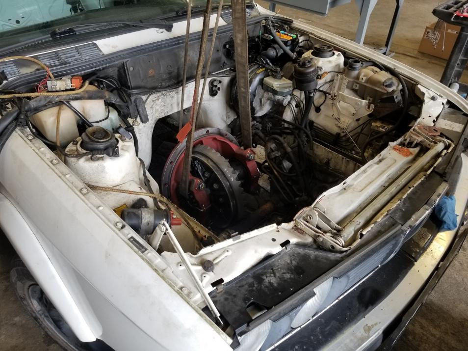

                      • 4x4_e30
                        • Sep 2013
                        • 164
                        Originally posted by The Dark Side of Will
                        Lol... Not 8x6.5"? Swap the rear to a 14bff?
                        I don't think its going to fit.
                        • Kershaw
                          • 11822
                          Did you try hammering the firewall in a bit?
                          AWD > RWD
                          • The Dark Side of Will
                            • Jun 2010
                            • 2796
                            [ATTACH]122285[/ATTACH]
                            Well... That's the front.
                            Also not a 14 bolt.
