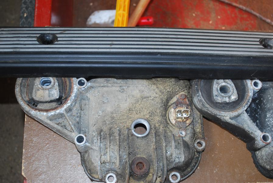

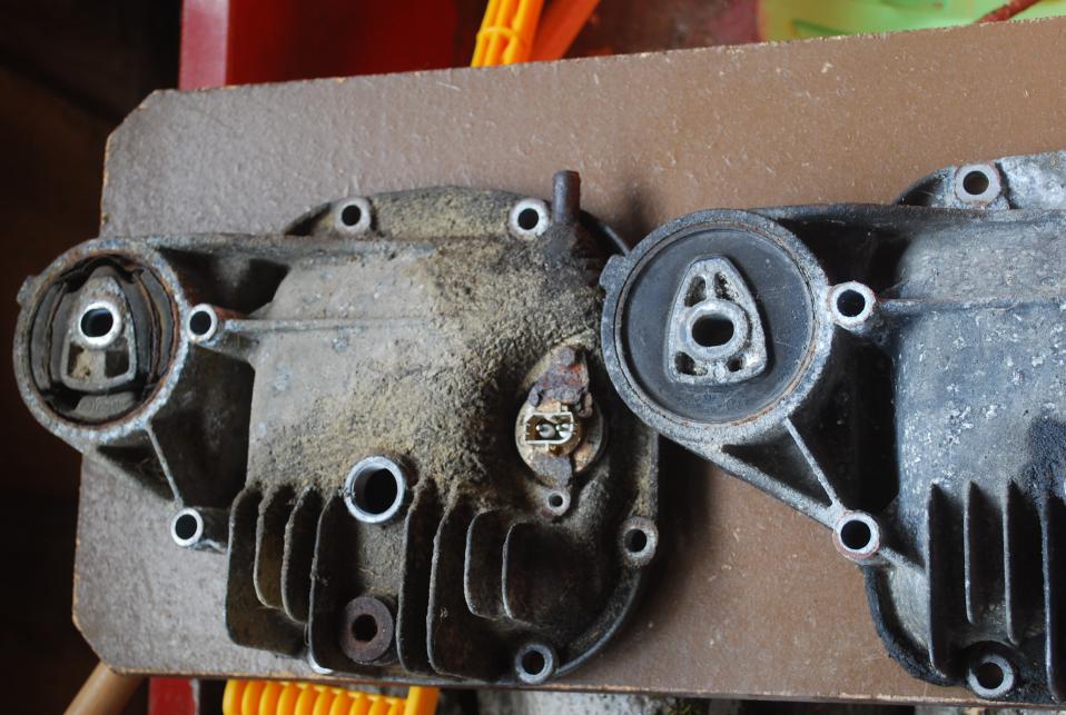

            The iX and RWD cars definitely have their center mount holes in different locations. I can provide pics if there is any doubt.
            • nando
              • 34844
              yeah, post it! it's been years since I've had a stock one in front of me.
              Build thread
              Bimmerlabs
              • packratbimmer
                • Dec 2009
                • 1335
                iX on left and RWD on right. Notice straight edge aligned with bolt hole.

                  Very helpful thanks for posting! So looks like the best option (to save money on the bushing anyway) would be to use the RWD bushing and shim the diff as mentioned by Nando in the other thread.
