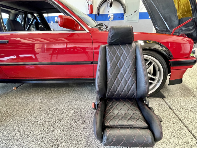

          • BMW_TUNER
            • Jul 2006
            • 1386
            Lseat.com full customizable and reasonable. Click image for larger version
            1989 332IS -S-Fiddy Four-Some weight removed.
            5 lug E36 M3 Brakes Coilovers and LTW's and No ABS.
            • kronus
              • Apr 2008
              • 13032
              that's ... not a great example, unfortunately.
              I've had experience with a couple different kit manufacturers.
              LSeat - their default material sucks. I won't even call it leather. their upgrade leather is better. Customization is possible but they have <50% success rate understanding and following instructions.
              zoomzoomzoom - I've had reasonable experiences, the owner has been in the business for a long time, running a local upholstery shop in LA. Customization is possible, he'll happily use materials that you send him, and things are generally well made. Expect it to take longer for non-premade things.
              falvalle2012 - vinyl only, but the patterns are really good. Communication, unfortunately, is bad, and no customization.
              GAHH/WorldUpholstery - $$$$, seem to be very well made. I've only interacted with their kits secondhand, but they look near factory quality.

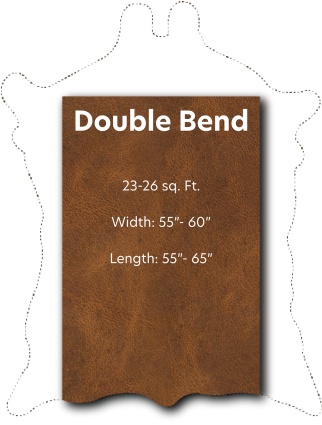

                      I visited several leather stores.
                      A typical 50-square-foot cowhide can cost from $150 to $700 and more, even at the same store.
                      Two front seat covers will require a full hide or even two. They can't cost $350.
                      Cowhides can be 6 mm thick, so leather professionals split them into layers.
                      The top layer is the best, of course. It can be 1-1.5 mm.
                      The bottom layer is the cheapest. A shop can add paint and pebbled finish on it, then sell it cheaply.
                      Then, parts of each leather hide are different. The neck has stretch marks. The belly is the worst as it's softer and stretches a lot - it's usually considered trash.
                      The Bend is the best part.
                      Click image for larger version  Name:	Double_Bend_with_dimensions.png Views:	0 Size:	152.4 KB ID:	10163512
                      I have many samples now.
                      I can definitely say that only the most expensive Italian leather is good. It's smooth, it feels nice to touch, it doesn't show imperfections.
