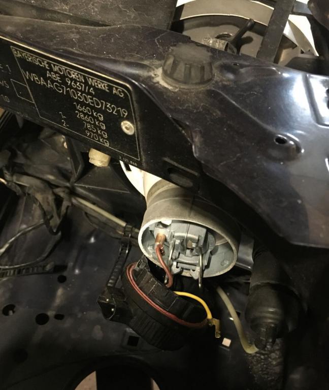

    ​Existing
    • EastCoastErik
      • Sep 2020
      • 112

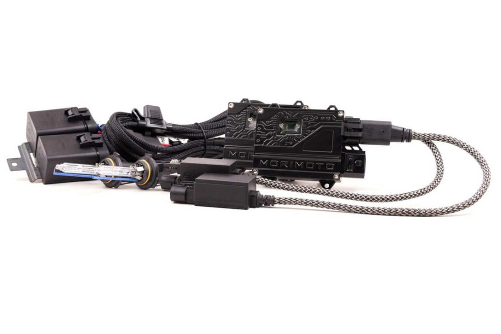

      • EastCoastErik
        • Sep 2020
        • 112
ID:	9979646 Click image for larger version
ID:	9979647 What I'm looking to install

          There are topics about replacing the projectors to Morimoto, etc using 3d-printed adapters.

            I had a premium hid kit and then I bought a led set and they are cheaper and work better than the hid kit. The led installation is plug and play.

              H1 HID bulbs are extremely common. I dont know why you can find them, a quick search for me popped up many examples.

                  The latest generation of LED bulbs are extremely impressive. I would go there instead of HIDs at this point.

                      If you are going to an H1 HID kit you will not be able to use the back caps.
                      I will say this as others have said I went from HID to LED, pretty similar light output, get to full brightness faster and way cheaper and easier to do, just plug and play.

                            If you already have the kit and cant return it you might as well go with HID. But personally since you have the projectors its way easier to do the LED and its cheaper. Shadowline motorsports has a thread on here on them and I bought from him.
