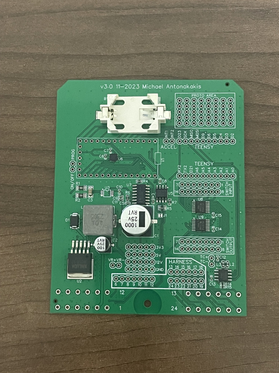

                      New batch of circuit boards ordered! I did a whole lot of redesign on the layout, and the schematic has some changes, namely the addition of two TPL7404L chips. These are MOSFET low-side switch/driver ICs, with 7 channels each. Each channel is capable of sinking 600mA. This adds a ton of capability for doing things like directly driving dash indicator lamps or controlling relays with the Teensy.
                      Click image for larger version  Name:	PCB-v3.0.png Views:	0 Size:	314.7 KB ID:	10107680
                      I'll explain the current features:
                      • Designed for use with Teensy 4.0, may work with other Teensy boards
                      • 24 pins for power and I/O, will include a flying lead harness (2x12-pin Deutsch DTM connectors)
                      • There are 5 permanent pins routed to the DTM connectors (Gnd, 12V, CANH, CANL, 3.3V), all other pins are broken out on the PCB with through-holes to be wired as desired for each application
                      • 12V-5V power supply built into the board to power Teensy, Teensy will provide 3.3V. All voltage rails (Gnd, 12V, 5V, 3.3V) have 5-pin breakouts to use as desired for each application (e.g. use 3.3V for analog pressure sensors)
                      • Two TPL7407L 7-channel low-side switches with input and output pins broken out - simply add a jumper wire from a Teensy pin to a TPL7404L input pin, and a jumper from output pin to DTM pin to allow the Teensy to control loads up to 600mA
                      • MAX31855 thermocouple amp: you can wire a thermocouple directly to the DTM connector, e.g. for EGT probe (1-channel for now)
                      • SN65HVD230 CAN transceiver: tap into a CAN bus on the vehicle, Teensy 4.0 has hardware CAN but still needs an external transceiver.
                      • MAX9924 VR signal conditioner: wire a VR sensor directly to the DTM connector and get binary output directly to the Teensy (e.g. turbo shaft speed, cam angle sensor, etc.)
                      • ADXL362 accelerometer: 3-axis accel with configurable +/-2, 4, or 8g range, excellent noise filtering. Use it however you want, e.g. make a realtime g-circle display, log to your ECU datalogger, etc.
                      • Teensy GPIO breakout: all non-dedicated Teensy pins are broken out with through-holes for interface
                      • Breadboard/proto area: 8 sets of 5 connected through-holes for building any additional circuitry - for example the econometer on our e30s needs a 12V PWM signal, so you can use one of the TPL7407L pins and the 12V breakout pins to add a pull-up resistor to generate the PWM signal for the econometer
                      • Coincell battery holder, used to provide power to Teensy for its built-in real-time clock
                      As an example, here's how I'll wire up my e30 with the following features:
                      • CAN-controlled VGT turbo
                      • turbo shaft speed sensor
                      • control of a relay to power the VGT actuator
                      • compressed air dual solenoid wastegate control
                      • MegaSquirt2 CAN bi-directional data (receive data from MS2, send additional data back to MS2 for datalogging)
                      • analog pressure sensors: fuel, oil, exhaust manifold, and wastegate dome pressures
                      • econometer signal
                      • EGT probe
                      • touchscreen dash display
                      Despite all that, I have a few pins left empty, and could free up a few more with a couple minor changes to my existing wiring harness.
                      Click image for larger version  Name:	image.png Views:	0 Size:	106.3 KB ID:	10107681

                        New PCBs arrived Wednesday (ordered on Friday! Crazy fast turnaround!) Need to populate the MAX9924 chips (PCB supplier was out of stock), but they’ll be here Monday. Weather will be nice for the next week or so, maybe I’ll be able to get it in the car for a test drive soon :)
