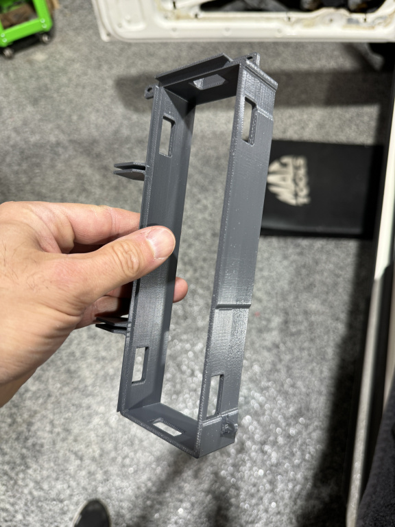

                      Thanks again!!! I downloaded the files and printed them on Xometry
                      For others, this is the site that sells some other goodies (takes original radios and adds Bluetooth which is great): https://bmw-radios.com/ . Really cool for those looking to keep the original radio and add Bluetooth to it. Their microphone that fits into one of the blanks above the radio is perfect too.

                              Well, I finally got to the point of mounting the radio using the E30 Radio Adapter _BMW 65121375737​ file and it worked out perfectly.
                              The only issue I would stress to anyone looking to do this is that, in the past, removing the HVAC console is usually really simple _if_ you leave the temp control and vent sliders in the dash. With this part in place however, this becomes near impossible due to the mounting screw behind the temp adjustment control.
                              I'm apologizing ahead of time to whomever attempts to take apart the console on my car as I'm sure they'll have no way to figure out how to get it out using standard instructions and will break something.
