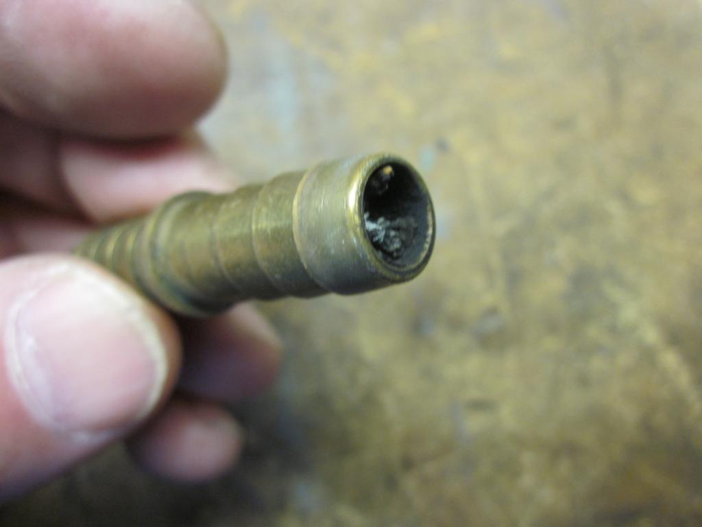

    Oh, and when I pulled the carpet I found this homemade one hitter underneath...
    guessing it belonged to that previous stereo tech eh?
