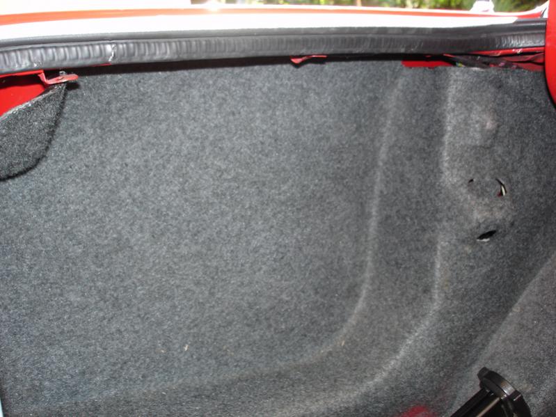

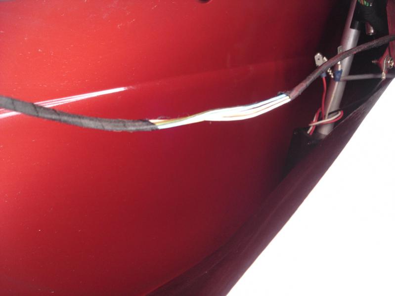

                      Rehosted pictures from OP.
