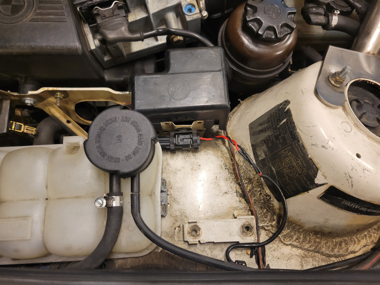

    I had a bug to replace the crumbled orange bakelite plastic connectors for my ABS sensors. I wanted something that would look neat, seal well, and fit snugly within the factory clips for the original connectors.
    I sourced these off of eBay: "2Pin Way 20AWG Waterproof Wire 1.5mm Series Terminal Connector" (https://www.ebay.com/itm/315225258620).

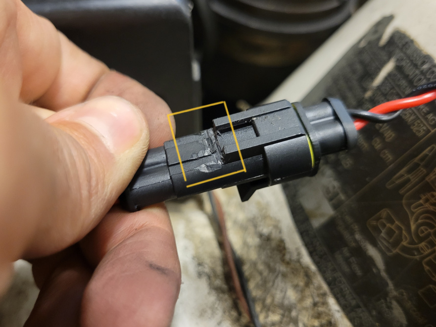

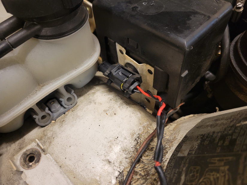

    I shaved them down a tiny bit on the back, and they fit *beautifully*.

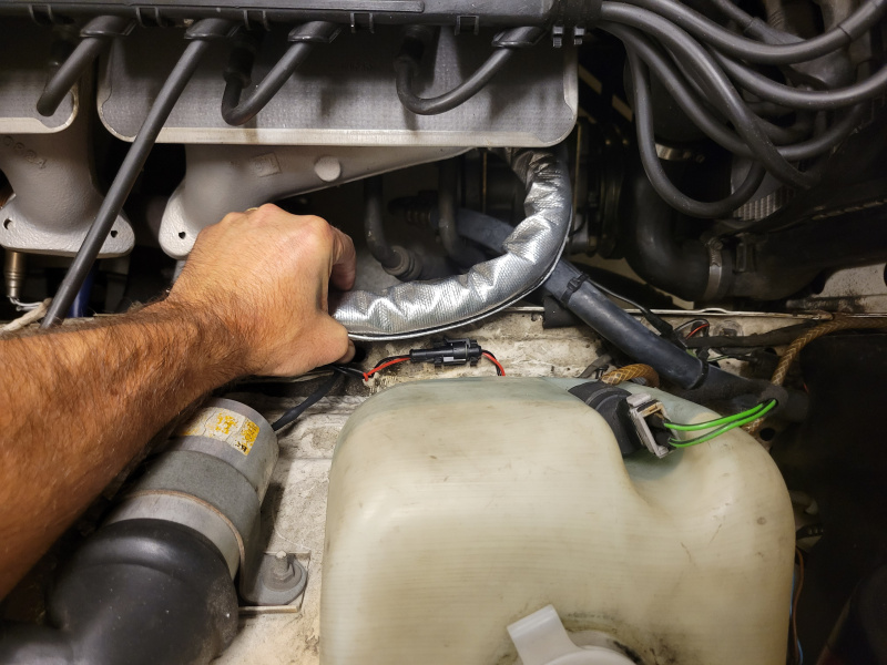

    I soldered the connections with some 3/32" 1:3 ratio, adhesive-costed shrink tube, and I'm very happy with the results. image widge

      BLE, Yours does fit nicely in the clip.
