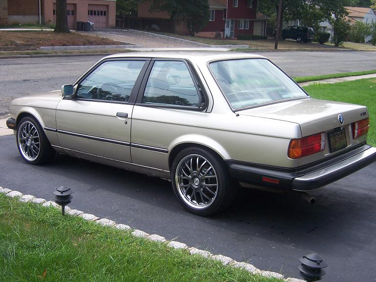

Originally posted by delatlanta1281Done!!!!
Love it! Gotta do my B pillers though.
