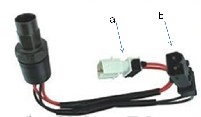

                So, my old r12 dryer had two pressure switches. My new 134a dryer has only one switch. should i just double up the wires both going to the same switch?
                Everything else is done so i'm stoked to get this thing charged.

                  #143
                  further pics of my pressure switch question.

                      That connects to another pressure switch. pre-'91 e30s had two separate switches.

                        #146
                        Ok, I've got a High+low pressure switch in one housing from an E36. Pic attached here. Which connector is the high switch and which one is the low switch?
                        Thanks
                            Thanks
                            Check for continuity, the low pressure would be open circuit with the switch uninstalled. The High would be closed.
