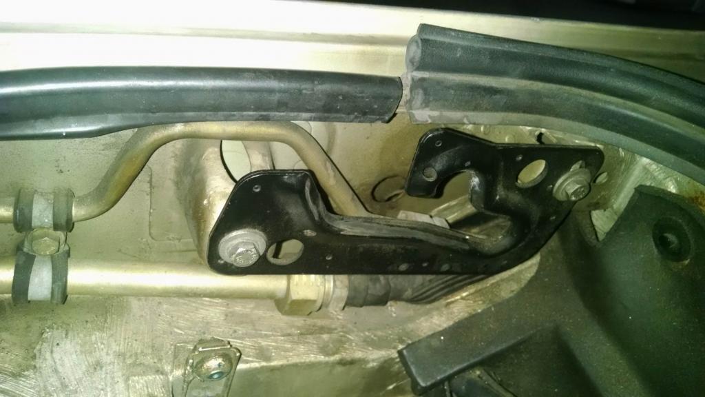

                Just chiming in now after overhauling my AC the past few weeks.
                I found a Sanden R134a compressor out of a '91 e30 vert. I'm not sure if this was originally converted from r12 or was r134a from the factory. Anyway- as mentioned before and in other threads- Sanden is an overall awesome compressor and is specifically made for r134a. Hearing the great reviews on it and rather than retrofitting my R12 Bosch, I decided to use it.
                Unfortunately, the mounting bracket that the Sanden uses is different than the stock R12 AC mount. I had to extensively modify the Sanden bracket to work. The mounting holes are the same, but the CPS bracket and an ear on the block are in the way. Ended up using my Dremel and a grinding disk to make clearance on the bracket- along with grinding down the CPS bracket a bit.
                Then the Sanden IN/OUT fittings are in the rear of the unit- not in the center like the Bosh or OEM units. If you have a 325i or M20 with an oil cooler- you will have to modify your lines. I ended up getting mine re-done with barrier hoses. I added a hose from the front high pressure union to the compressor union (added about 5 inches in length for the curvature- removed the hard line sections and added two straight hose fittings to both ends. I would do a bend, something less than 90 Degrees for the condenser fitting) For the low pressure side, I had it shortened by 3 inches with a barrier hose. While the high pressure hose worked out perfectly, I should have removed only 2.5 or 2 inches from the low pressure hose, as it is a little too short and I need to figure out a good house mounting bracket- as in my pictures it is zip tied to the dizzy. I ended up having enough wiggle room to route them through the oil cooler lines.
                Vac'd my system down to 22mmHg with my crappy 5hp 20gal compressor for a good hour, added new oil, a new parallel flow condenser from Amazon (the one pictured a few times in this thread) new aux fan, R134a expansion valve, new dryer with one pressure switch (modified from two switches) and of course new O-Rings.
                Blowing out a nice crisp 28 Degrees at idle on a 86 degree day at 50% humidity. The Sanden compressor is quiet as hell, can't even tell it is on (but it is!) It was a overall a giant pain in the butt project- but thankfully I didn't have any leaks or issues after getting everything squared away.
                Sanden Bracket- modified
                Routing of the AC lines through the oil cooler lines. I wrapped them with exhaust wrap I had laying around since I didn't want the rubber to melt being that close to the exhaust manifold.
                The only pics I took of the modified lines. The high pressure side has that same fitting on both ends and only a rubber hose in-between (no hard lines)
                PF condenser and new aux fan
