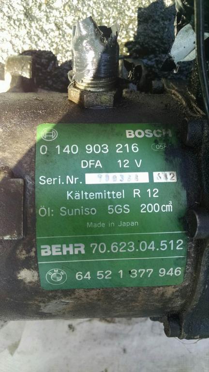

                                Are R12 cans off Ebay any good?
                                Hey guys, I do not mean to derail this thread but I would love an opinion on the path I’m about to take with my A/C.
                                Several years ago I put a compressor straight from the junkyard into my ’85 325e and charged it with R134a (and a new dryer). Flying in the face of “doing the right thing” it has actually worked extremely well, until now. By that I mean that my system is stock (R12), the compressor I got was probably stock (R12), and I did nothing to “convert” anything. The eventual failure was the compressor seal.
                                I just picked up a comp (see pic) from the yard again and was going to do the same thing however I am considering getting some R12 off ebay (in cans) and charging it with that this time, since I didn’t have any appreciable leaks in my system and I think I can reasonably expect it to last for a while as such.
                                What do you think? Ya, the R12 is probably going to cost $70 or so but it’s worth it to me if it doesn’t leak out. Does anyone have experience with the R12 cans? Since my “new” comp probably has R12 oil in it already, shouldn’t it be plug and play? I read all of the dangers of mixing R134a with R12 oil so that’s just another reason I’m considering this route. Thank you for your thoughts!
