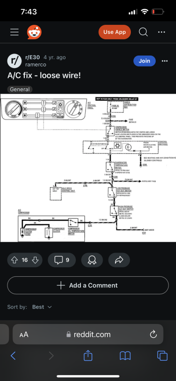

            • prisonerofdoom83
              • May 2013
              • 529
              #696
              So a quick question hopefully someone can chime in . Is the aux condenser fan supposed to turn on with the snowflake button? With an empty system? I know the compressor won’t kick on until I start to fill . Is it the same with the fan? Right now it’s not turning on with no Freon in it . The fan does work I bypassed at the high temp switch . Everything is brand new
              edit never mind I had a bad connection at the evap temp switch . I found this wiring diagram that helped out

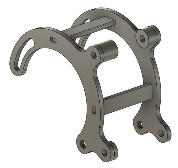

                      #700
                      Adding to this thread as many people come here first (as I did when I started my conversion). I created my own Sanden bracket and released the project files publicly: https://www.r3vlimited.com/board/for...for-m20-engine

                      • 510man

                        • Chilezen
                          I weld cats
                          • Dec 2013
                          • 1942
                          #702
                          My shop has a laser machine, I can cut these out for you/anyone that wants to buy them. DM me if interested.
