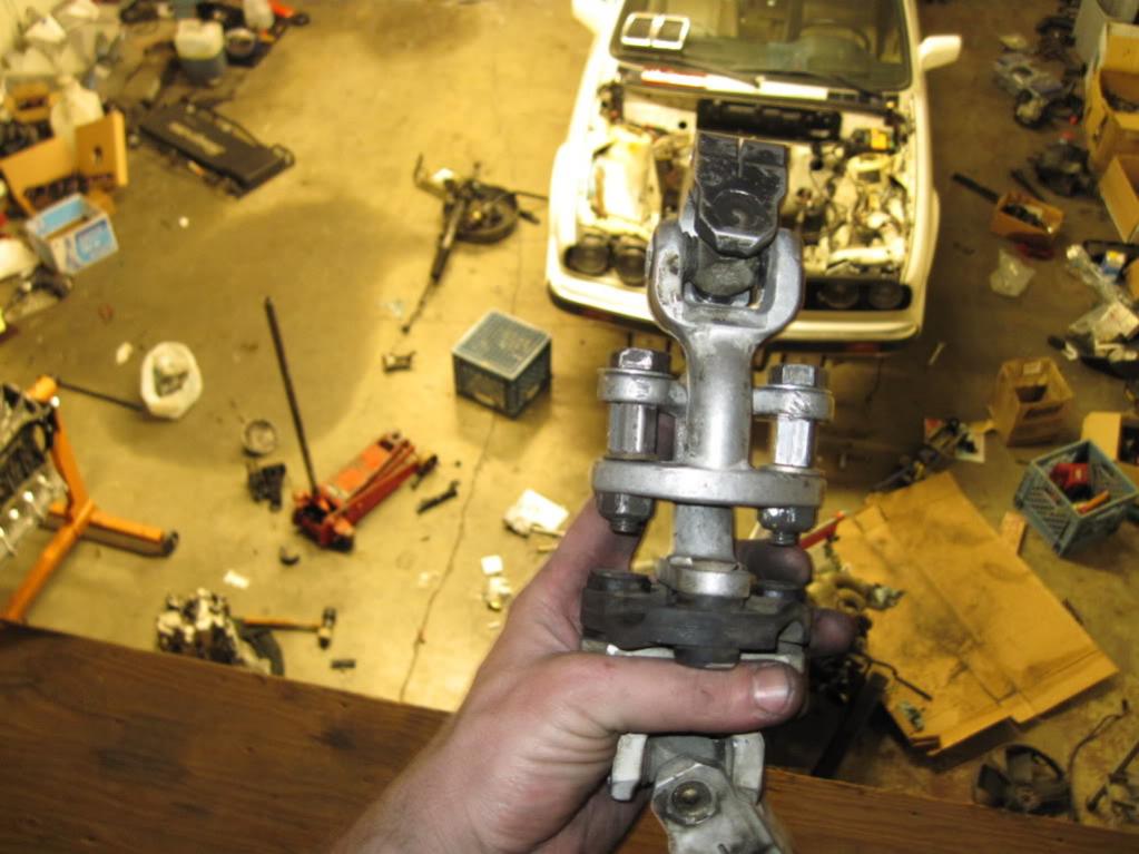

  • LateFan
    replied
    When you look at it modified, there's not a lot of collapse distance even if it does shear the threads. Inch and a half?

  • LateFan
    replied
    Originally posted by marshallnoise
    Nylon and heat cycles spell disaster.
    ah, that could be a problem.
    I found some higher heat plastics at McMasters....
    McMaster-Carr is the complete source for your plant with over 595,000 products. 98% of products ordered ship from stock and deliver same or next day.
    They list acetal, PTFE, PEEK, and polypropylene with higher temps.
    Leave a comment:

  • rturbo 930
    replied
    LateFan, I had the same concerns too that I would be compromising on safety if I did the mod shown in the OP. But, based on a bit of research I did, the guibo has a safety feature too. I couldn't find much info on it, but it seems like the guibo is designed to let the two parts of the shaft separate in the event of a serious crash, or something to that effect - don't quote me on that though.
    I also read that installing a solid guibo isn't something you want to do in a street car because of the amount of vibration that comes through the wheel. But this is all based on hearsay pretty much. I haven't had the shaft apart to look at how it goes together, and I don't have any experience with a solid guibo either.
    So it seems that no matter what you do, you have to make a compromise. Not sure which I'll do, but I'm leaning towards keeping the guibo. Reason being, it seems like the two long studs you'd replace would only allow it to collapse and inch or two at most, so you're not really losing all that much in terms of safety... but I could be underestimating their purpose.
    Leave a comment:

  • LateFan
    replied
    Just to add some more noise to this ongoing and really valuable thread - Our stock rack seals are failing, so it's time to do the E36 swap now. Good reference here to counter the heresay about which rack is which…
    I have a serious question about the collapsibility that was designed in to the stock steering linkage. I've posted some questions before in the steering section about our odd-looking hardware, which I've found was because of an earlier recall for safety. As the linkage shears off the rivets in a front end crash, these steel plates keep the ends of the shaft aligned so you still have some steering.
Name:	steering plate.jpeg
    The newer (replacement?) linkage has those long studs on it, which I assume does the same thing - the pieces slide down those studs, but are still aligned so you can steer.
    A guy WAY back in this thread mentioned trying to use plastic nuts or some solution on the linkage spacers so they'd shear off in an accident. I don't know the result of his experiment.
    All the aftermarket linkage kits are pretty clear that they're "track only" pieces for liability reasons, and say you should be wearing a harness so you don't hit the wheel. For a street-only car, that doesn't seem like a decent solution. My kids will be driving this car.
    In post # 865, a guy mentions it:
    2) Safety Loss--The mod that everyone does takes away the column collapse safety feature. I am interested in the method shown in post #856. I didn't do this one, but wonder if it would be the safer route. Watch the column come at the dummies head in this video on the old chevy at 49 seconds. Sorry to be a Buzz Killington, but it is worth mentioning.
    These guys have a telescoping center sleeve, but they say the same - track only.
    chrisnxl185's solution of taking out the giubo and bolting the two halves together with a heavy washer leaves the shear hardware intact, but is a more rigid connection. Others have said that rubber giubo is just for noise isolation and not to worry about it.
    I'd like to use the Dungeon spacer kit.
    The later cars had a solid shaft with no collapsing hardware, but of course they have an airbag to break your fall.
    So..any other ideas on leaving this safety feature intact while shortening the steering shaft?
    Leave a comment:
