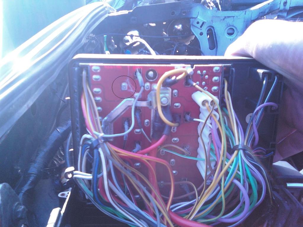

    heres the updated pics. its an easy mod if you can figure out how to solder. the hard part was figuring out how to do it. this lets you put the foglights on whenever the parking lights are on which means they can be on with the high beam or with just the parking lights. they also stay on with the key off if you left your headlights on. the car was a 1990 i dunno if other years are the same
    Originally posted by Spinning Tires
    take out the one relay and take out the three screws
    then break the connection on the circuit board with a screw driver or a utility knife. solder a wire to the spot right next to the break you just made. in my case i used a grey wire. this connection is located directly opposite the side where the relay was removed to get the screw out in step one
    Last, connect it to the parking light wire which runs through the inside of the fuse box. you can use a test light for this or just see what color wire is going into your parking light.

      It might be a good write up but the pictures are terrible. Where do you break the circuit board and where do you solder the wire, i'm sure there are more people who don't understand this write up by looking at the pictures.

        alright i'll get you a better pic. all you had to do was ask

          It goes to the back of the 85 terminal on the fog light relay. You better be able to figure it out from here cause I just broke the wire off while trying to get a better picture

            i have an early 88
            where your gray wire is soldered in... I have a yellow wire looping around?

              well i've done this to my 90 my cousins 91 and my friends 87 so i dont know what to tell ya.
