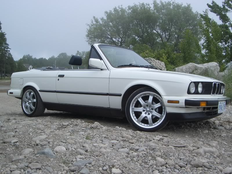

      Mine is an 11/87 build. Before and after pics below... rear valence, skirts, and front lip are from eurostyle (www.maxbimmer.com)
            Hey,
            So those side skirts are (eurostyle} mt2 cabrio units, or, coupe/sedan ones ?
            Asking since you retained that lower black trim piece, hence, I wonder how would you add mt2 door/fender & 1/4 panel mt2 cards to them.
            I have a oem mt2 cario kit, those side panels slide into skirts as they act as the lower retention point.
            Aloha
