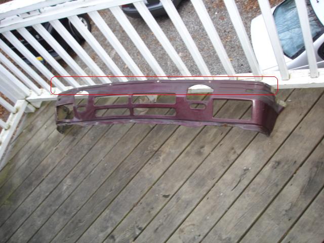

    This is what the valance on that red car is. If you don't want fog lights. They sell covers for the holes.

      Thanks. What does it come off? What's the lip on the bottom?

        It's off of any 83-85 euro car. And it uses the lip with the brake duct holes in it. The lip is on any 85 and back e30.

          Damn, well I'll start looking when I have the money I suppose. What valence has the foglight holes for euro's? Like an is or es or what? It looks like the valance in kronus' sig doesn't have integrated fogs.
          That pic is old, I had the US diving board valence at that point. Currently have the one JasonC posted.

                  Anyone know if fogs from a us 1987 is will fit the holes in the euro valence?

                            Early / external US fogs do not fit euro valences, but, m3 and MT1 fogs will fit.
                              nope...you need the euro buckets and m3 lens
