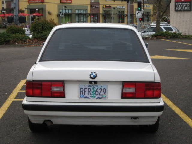

                        Duplicolor Metalcast, two coats of clearcoat, then two coats of enamel over everything:
                        1991 BMW E30 318i sedan
                        2005 Kawasaki 636cc ZX6-R
                        PNWRiders.com
