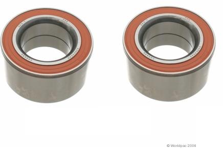

          Quick question - does it matter which side of the bearing goes in first? Mine are FAG bearings like in this picture and they have a bit of a "lip" on one edge.

            I also would like to know as my FAG bearing came in today. Also, I have read all the posts I can find about this job but would like to know about a definitive list of tools needed to do the job properly and easily.
            I plan to get the harbor freight bearing set and rent any other tools I need. Suggestions?
