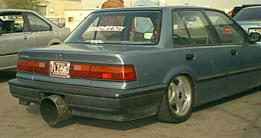

          Put this in and call it a day:devil:

            Originally posted by dnguyen1963
            [ATTACH]111978[/ATTACH]
            This is the answer to all of our problems! [emoji7]
