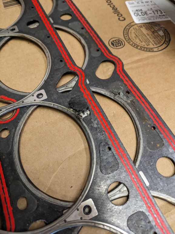

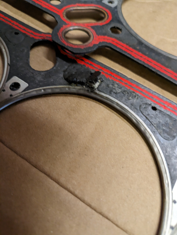

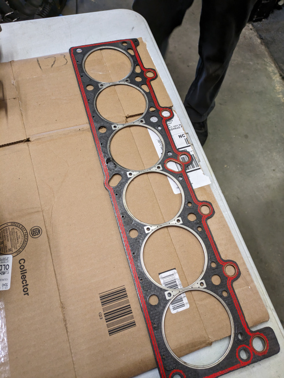

      Everything is almost back together. Here are pics of the damaged gaskets from the last two blow outs.

        Same cylinder, same spot both times?
        Yeesh I'd be checking that block & head very carefully to make sure they're straight and flat.
          Head came back from the machine shop with a clear bill of health. Block was checked as well. Fingers crossed that third time is the charm.
            Same machine shop that worked on it the last time?
