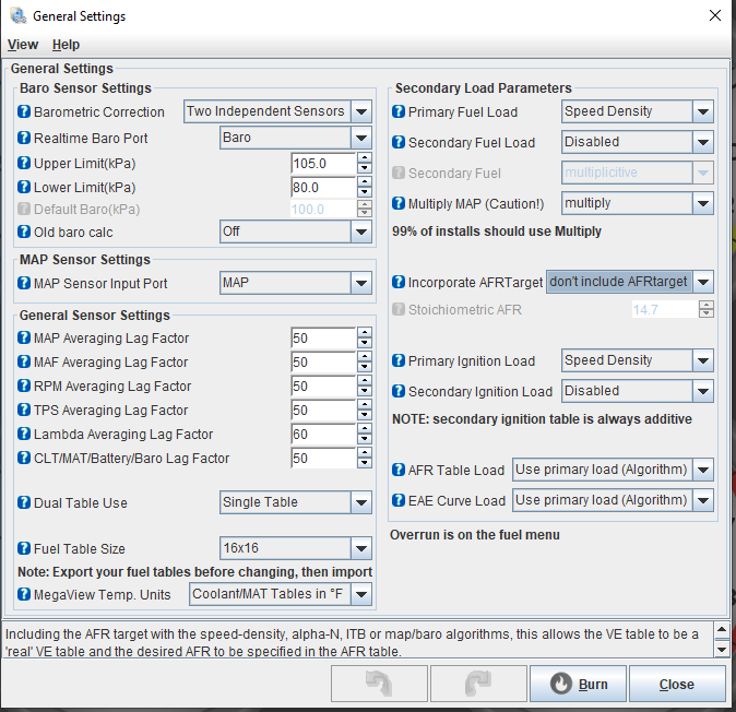

                          It appears AFR Target setting is off...
                          • varg
                            Florida Turbo Man
                            • May 2014
                            • 3405
                            That's not a cause, it's just something that will affect VE values. If you change it, the fuel table needs to be re-tuned. Not holding a consistent AFR during a dyno pull is a tuning problem not a settings problem. The ignition settings are, as mentioned before, more important.
                            IG @turbovarg
                            '91 318is, M20 turbo
                            • Rojoryu
                              • Jul 2016
                              • 58
                              Understood. I posted it since Panici has mentioned it in a previous post. That would mean that the AFR table I posted isn't being used correct? Thanks again everyone for all the insight. I’m learning lol.
                              • Panici
                                • Dec 2009
                                • 2493
                                You got it, that AFR table isn't being used in the fueling calculations if Incorporate AFR is off.
                                In other words, if you were to change the AFR table values right now, how rich/lean the car is running would not change.
                                With the caveat that with EGO correction turned on, it would use the AFR table to try and trim the fuel appropriately.
                                But as Varg said, it's not the cause of your lean condition. That's a result of an improperly tuned VE table.
                                It does however seem like an amateur move to have the option turned off when it's available for use.
