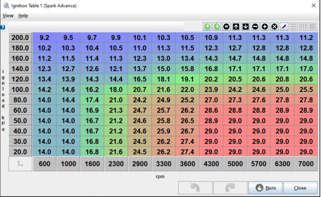

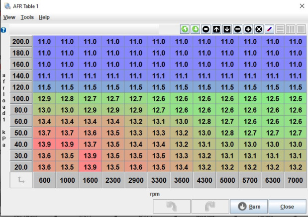

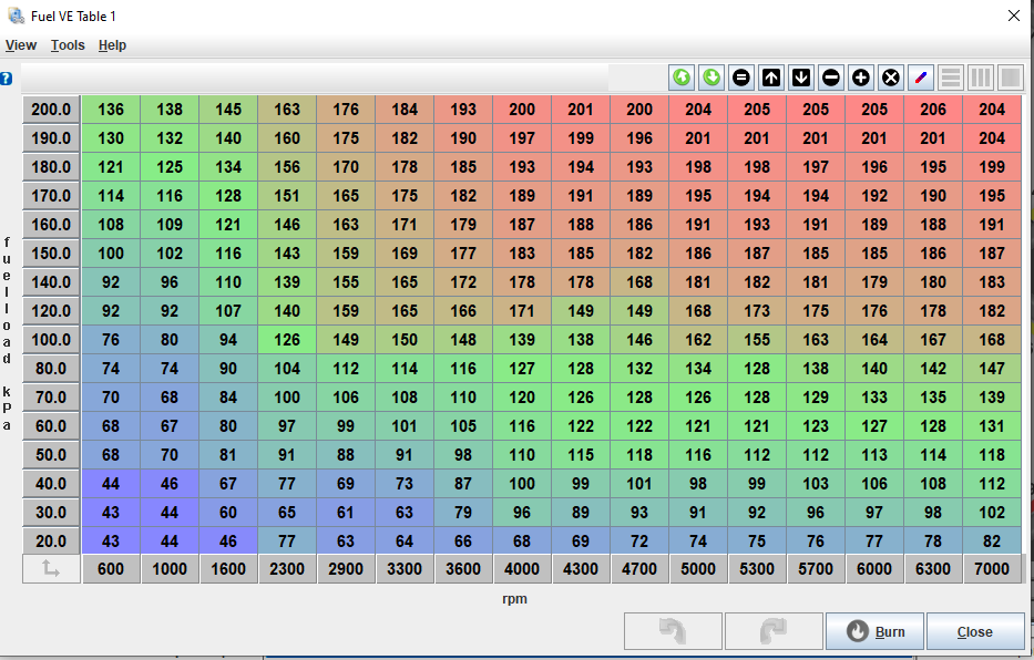

      Post your AFR/Ignition map. 13* is extremely conservative at 9psi
      It's probably having a hard time burning the fuel at higher RPMs if the ignition timing around 13* if anything
      • Panici
        • Dec 2009
        • 2576
        Maps attached.
        We were still roughing in the VE table, think this was one of the first WOT pulls.
        I didn't realize we pulled all the way to 6000rpm, I thought we got to 4000-ish.
        This would actually put us at 14-15* @ 160kpa.
        Wish I had logging enabled for exact data.
        We were having laptop issues and had to dump the project to my computer, and I didn't start a new log after that.

          Yeah, not having the exact data is kinda a killer here..
          Like, those numbers are fine... If that's actually where it was at.
          Without the exact data, next best thing to diagnose the issue is tear the motor down and see what happened.

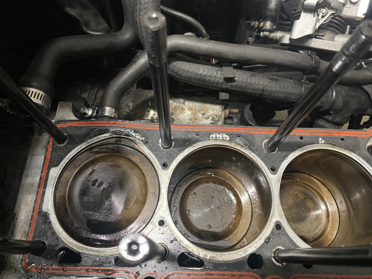

            Okay small update - Had some time yesterday night to tear everything apart and thankfully looks as though it was HG failure.
            Tested compression and had ~160psi in first 5 cylinders except 10psi in #6. Pulled the head to inspect:
            Now, if this was caused by a warped head or incorrect torque I don't know. Current plan is to get it off to a machine shop for pressure testing and resurfacing and then try again being a little more conservative with the boost until I know it's safe.
            Anyone on here have recommendations for using ARP studs?
            Wondering if I installed wrong - Process was to clean all threads with ARP chase tool, remove gunk from holes then hand-thread each stud into the block. For the head, I used ARP assembly lube on both sides of the washer and underside of the nut and torqued 3 equal steps to 70ft/lbs.
            Thinking that this time I'm going to reinstall studs and make absolutely sure nothing in the holes and additionally re-torque studs again after a heat cycle.

              Looks like it either wasn't torqued enough, or uneven sealing surface..
              Make sure when you lube the hole for the stud to use minimal lubrication... I personally do not lube anything except the washer under the nut.
              If you use too much, it can prevent the stud from going down into the block far enough.
              How did the nuts feel coming off around cylinder 6?
              My money is on something is warped. That compression ring is way out there.
                Any tips as to how much lube to use? Seriously though - maybe I used too much and the studs didn't hold properly. It was my first time using these.
                Cylinder 6 studs felt pretty solid tbh, not like they were any more loose than the others

                  If you lost a hold on the gasket because of the nuts being under torqued, you should feel that when loosening them up.
                  I'm reading back on the original post and remembered you melted a piston, which is why you're on the 2.7 block now.
                  885 heads do not like heat at all. I would not be surprised if that thing got damaged when it first went kaboom. At this point you need to send the block and head to a machine shop to guarantee that everything is flat and straight.
                  Ideally they're going to tell you the block or head was warped. Then you can rebuild with confidence because you'll have your answer to why the HG failed. When the resurface the head/block ask them to take a pic after the first pass so we can all see what it looks like, assuming its warped. Obviously, looking for paint to be left around cylinder 6 on either surface
                  How did the HG look when the engine failed on the 2.5 block?
                    Yup that's the plan! I've pulled it from the car and hopefully leaving it with a local shop tomorrow.
                    2.5 HG was an MLS gasket so only pistons and rings saw the brunt of the damage in that episode. I'm assuming that's why some people don't like the MLS as much as it's more likely to damage other internals, hence the fitting nickname 'boost fuse' for a composite HG.
