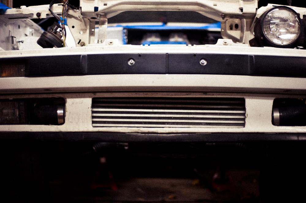

        Got this done, needs to be cleaned up and resprayed but looks better.

          Looks good, I have mine cut out the same way.

            Thanks man. Yeah I wasnt like super concerned with airflow, the IC is HUGE so cooling shouldnt be an issue but I think this just looks cleaner as you can run the stock plastic piece that fits in there.
