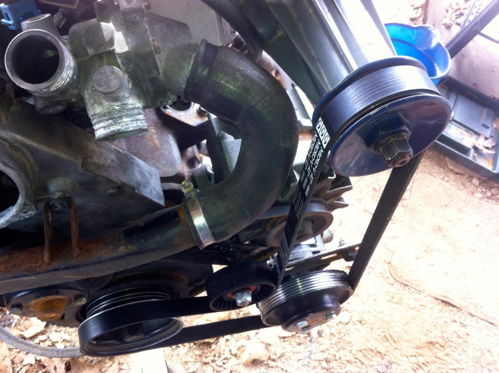

                        #146
                        Belt and pulleys.
                        Originally posted by Andy.B
                        Whenever I am about to make a particularly questionable decision regarding a worryingly cheap diy solution, I just ask myself, "What would Ether-D do?"
                        1987 325iS m30b34 Muscle car (Engine electrical phase)
                        I was born on 3/25…

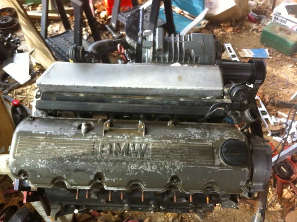

                          #147
                          One of the passenger side.
                          I was born on 3/25…
