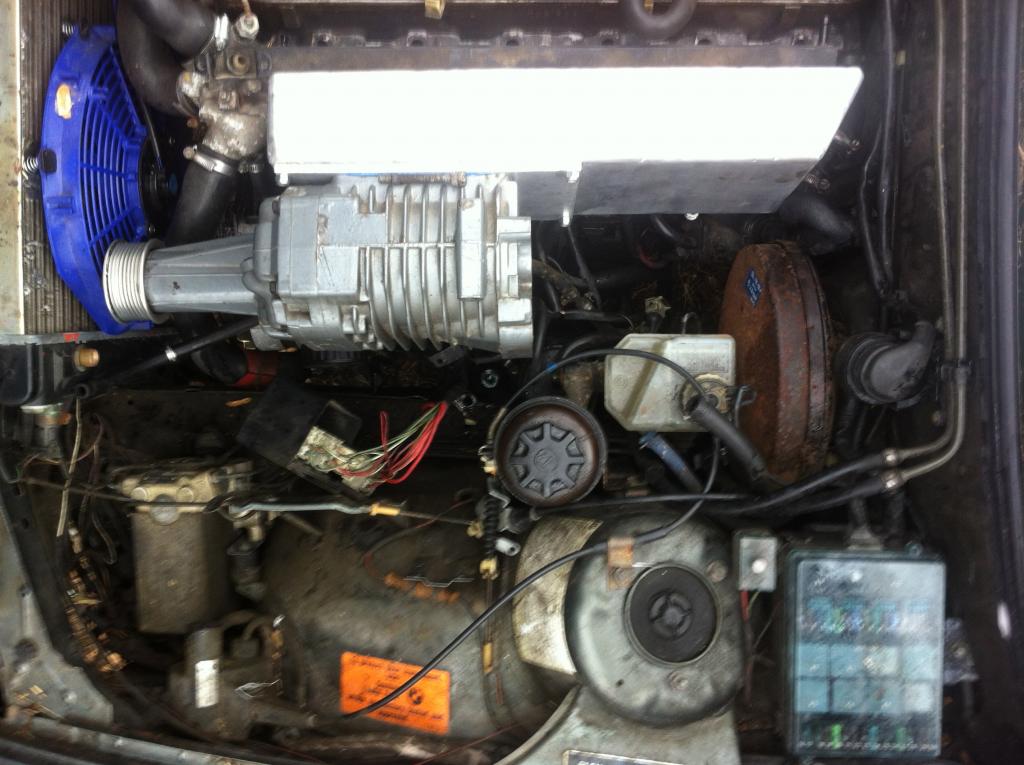

                  #98
                  It's official, it clears the hood. This is on my 87 vert. It has the old cooling system which doesn't work with my setup. But the important parts match. I'm in the process of bringing the 87 cabby back from redneck death.
                  Only problem so far is that the long stud in the center of the intake manifold has to be removed to install this. It can still be used, but it has to be pulled and inserted into the manifold hole before the manifold goes on and then threaded in. Minor inconvenience.

                  • Q5Quint
                    • Jan 2005
                    • 725
                    #99
                    How thick is that alum plate?
                    I think I am just going to do a mounting plate under the stock manifold out of steel and was wondering if 1/8" would do it. My belt setup should look about exactly like yours with the old belt tensioner from my truck.
                    • Ether-D
                      • Sep 2011
                      • 2838
                      #100
                      It's 1/4" plate. I wanted to be certain it would be strong enough.

                        • TheTacoMan
                          • Nov 2011
                          • 2308
                          #102
                          Just a heads up if thats an ebay fan, it will not keep it cool in traffic at all. My buddy had two of the same thing too.
                          Also clean that engine bay, its duuurrrtttyyyy
                          • Ether-D
                            • Sep 2011
                            • 2838
                            #103
                            It is, but it's just what came on my beater vert. It's not being driven. It's my test fit subject.
